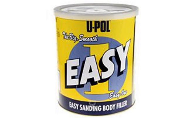

Just be careful when using that type of filler as its polyester based and wont adhere to epoxy . However epoxy will adhere to it no problem ,one of lifes little mysterys i guess lol  ;) .

im using Easy 1 filler, was recommended to me by Andy from Models By Design as i was also trying to figure out best stuff to use as im new to building also.
Easy 1 filler is good stuff, its like a thin paste thats easy to apply that doesn't run & its VERY easy to sand, it basically lives up to its name "Easy 1" :)
http://www.halfords.com/motoring/paints-body-repair/fillers-preparation/u-pol-easy-sanding-body-filler
