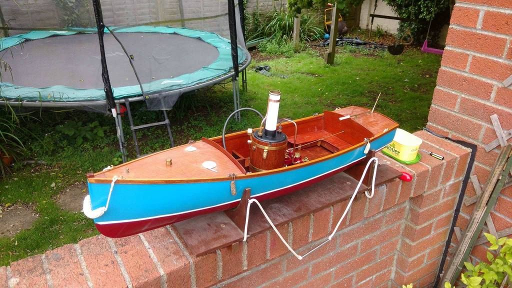

Thought some may be interested to see a boat I restored last summer. Picked up from eBay in rather rough condition...
Boiler re-painted, re-lagged, engine rebuilt with re-lapped cylinder and valve faces, made a set of new gaskets, and a repaint. The decking inside the hull was a rather horrible blue painted aluminium, this was replaced with wooden decking that needs to be covered with planking eventually I think.
Anyway, see the pictures below, starting with as bought.
I'd be interested to know what hull this has been built on - looking at an old Cheddar catalouge there is an identical hull fitted with a Puffin engine and named 'Puffin' and I've recently purchased an electrically powered imitation steam launch built on the same hull...

« Reply #1 on: April 18, 2017, 08:24:39 pm »
And some more pictures of the restoration.

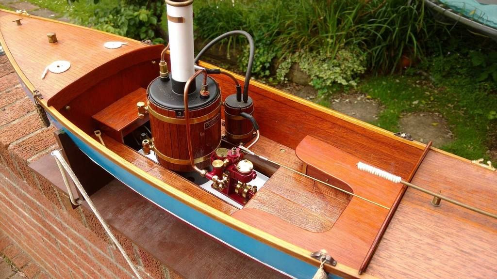

« Reply #8 on: April 27, 2017, 08:54:49 pm »
Some belated pictures of the nearly completed rebuild.
Still a few bits and pieces to do such as finish the edging around the engine compartment and apply suitable carpet and fake coal to hide the screw heads, but she looks alright on the pond!

« Reply #9 on: June 18, 2017, 08:49:38 am »
Congratulations on restoring the Cheddar steam plant, it looks like new.
However, may I suggest replacing the rubber tubing with copper or brass tubing and appropriate threaded connectors? It should look much nicer.

« Reply #10 on: June 30, 2017, 09:29:50 pm »
Thank you - I was rather pleased with how she came out. It's on the to do list - I always think that was one thing that let down Cheddar plants, however I can quite understand why they used rubber piping like that.
