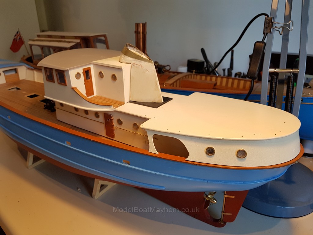

  • Posts: 1,425
Re: Billings Nordkap , Fun Build
« Reply #28 on: December 24, 2017, 06:01:02 pm »
Had a spot of bother with the kit piece of ply to fprm the hood for the exhaust stack. The ply just did not want to take up the shape required now matter how I tried. In the end I made the hood out of brass sheet and soldered it . Still took me several attempts to get the paint to an acceptable standard
  • Posts: 9,573

Merry Christmas Baldrick.......assuming that the propeller is as supplied in the kit, however looks a little small for the hull contour cavity.....Derek

« Reply #30 on: December 25, 2017, 09:55:39 am »
Thanks Derek and I wish the same to you down there in the nether regions.
It is a replacement prop, the one out of the box was a rather nasty plasticy thing all frayed around the edges. Although of the same diameter (40mm) it is not totally to my satisfaction. I got it on the web and it is a fabricated one with flat blades rather than cast with some nice shape to the body, may swap it later.
