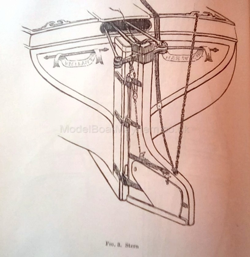

Mike....
It was a Will Everard model posting somewhere that caught my eye & I have read as much as I can find since and also joined the Facebook Group specifically for Thames Sail Barges.......[I see tomaracks postings there]
From the little detail available, many images do suggest the rudder blade was suspended on those two [2] pintals without any form of locking them down
So your theory around the safety chains appears most logical :-))

     Believe me, they are kicking chains (see my reply#12 ) to stop the rudder slamming about when anchored and possibly damaging the steering gear. Smaller barges had one, larger coasting barges like HYDROGEN had two.When not in use and slacked off, they would tend to swing around and bash the transom, so the slack bight of the chain has a line attached and this is pulled up tight to the rudderhead usually with a small block.
     The rudder would normally pivot on three or four gudgeons on the sternpost, with a single long iron pin going down through all of them. This would have to break  and come out to allow the rudder to part from the stern post, so would only be likely if the barge were rammed from astern, or grounded on rocks.
       I've now realised that I haven't actually got any kicking chains on my model, so I will have to look out for some suitable chain. The trouble with detailing is you never know when to stop....... :-)
Sounds like a man who knows what he is talking about !
Also just realised that my barge is also missing said chains, now where did I put my odds and sods tin ?

The rudder is held by a steel rod passing through the pintels on the rudder and the stern post, I know that because I helped fit a new one on the Mirosia . We had to use a 14lb maul to drive it down because her stern post had bent slightly with old age. Also most barges had one kicking strap aft, as previously said to stop the rudder juddering against the steering gear and keeping the master awake in his bunk, secure it and then turn the rudder into it and then put the locking pin down on the steering gear. May be of interest one of the bigger barges built was the Sarah Smeed off Faversham owned by Smeed and Deans, a 241 grt schooner rigged barge, 125.7 x 25.7 x 11ft. Spent my youth sailing on them, with some of the older well known ex trading masters of the time.

Found this on Facebook...
I thought, wrongly as it happens it was only a feature of our models that require extensions to the rudder to make it work !! Today I bought a super 1933 book Sailorman by E G Martin OBE which has some really good sketches and he recalls his time as mate on the tsb Vigilant. Thought this may be of interest 😀
Regards Ray

The chains have nothing what so ever to do with the rudder breaking off, they are to to stop the rudder kicking against the steering gear in a seaway when at anchor. The barges did have a general crewing number depending on size and trading distance. Any where from 2 to 4 men. Though my Grandmothers uncle sailed his barge in the 1st W War to France and back single handed, then the Freght rates were astronomical compared to peace time and he received 50% of the freight rate. I did know of a couple of skippers who had their wives instead of the normal mate. Have uploaded a pic of Goldfinch reckon to be the prettiest barge ever by the old Sailorman, her last was Dickey Doddler.

The jibs on the model.  Yes, the outer jib, the jib topsail is upside down. The topmast forestay on which it is fastened should go to the top of the mast. The stay for the middle jib, the jib should co to the lower end of the topmast housing, not as suggested the top.
The heavy chain across the deck is inaccurate.  There was usually a steel plate bolted down to the deck, then rods coming from that on each side connected to a short length of chain which went through the pivot point of the leeboard  and was held by a three curved prong fitting through the chain. Leeboards were raised and lowered by a crab winch on either side, well back abaft the main horse.  The wire from the winch went through a pulley on the outer edge of the deck and down to a chain     through a small hole in the top of the after most end of the leeboard.  They were raised and lowered depending on tack, with the weather 'board up and the leeward one down.
Most barges in latter years has screw type steering.
The light chains going from deck down to outer end of the rudder
[size=78%]were kicking straps and were tightened up after anchoring to stop the rudder slamming around and making a lot of noise in the aftercabin.[/size]
