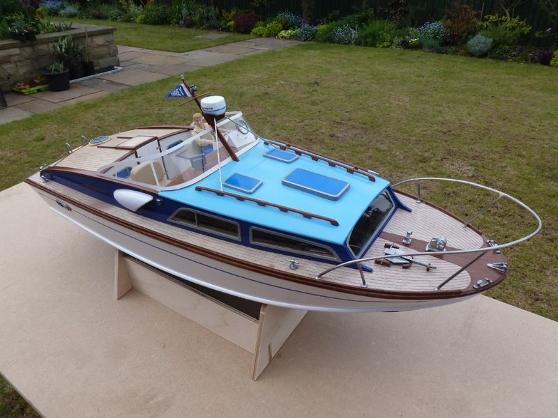

There are numerous piccies of real Swordsmen on the Fairey Owners Club website Gallery.
 I based my own pre-production model for the SLEC kit prototype on Tireur. The deck planking was laser-scored for me by those very nice people at Watton in birch ply. On that particular model I went for the "honey-coloured" effect by using Rustins Plastic Coating (which is actually a very hard 2-pack furniture finish) with a mahogany surround. I later found when doing a subsequent model of Huntress that this gives an excellent reproduction of weathered teak when you use the OSMO stuff suggested by Andy Waters on his Lobster Boat. It's eye-wateringly expensive but I have a lot left over - make me an offer? 8)
Attached photos relate to Huntress and link is to my model of Swordsman.  https://www.modelboats.co.uk/sites/2/images/member_albums/1480/829730.jpg
If you can drawn an accurate template of the planking shape, preferably in CAD, then I'm sure that a laser-scored deck and cockpit floor panels can be arranged.
Dave M

My build is at 1/10, the kit supplies 1x1mm (lime.?) as a spacer between the 1x3mm mahogany strips.
So I'm just butting these together, I think this is an intentional two tone effect to the planking rather than a caulking effect.
I guess you have a slightly different effect needed, so yes a slight bevel might work with some suitable filler.  I'd defer to the Swordsman builders on that... And for sure test on scrap first.
Best of luck
David.

That looks nice David - and it suites your boat really well.
I will be practicing on some scrap off-cuts long before committing my activities to my Swordsman deck!
