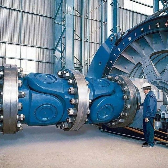

  • Posts: 24,070
Re: Uj joints for brushless motors
« Reply #57 on: October 26, 2023, 03:04:27 pm »
   This is what we need! ...
ooyah/2
  • Posts: 772
  • Location: Glasgow
« Reply #58 on: October 27, 2023, 11:41:12 am »
Wow,  That's what I call a coupling.
George
