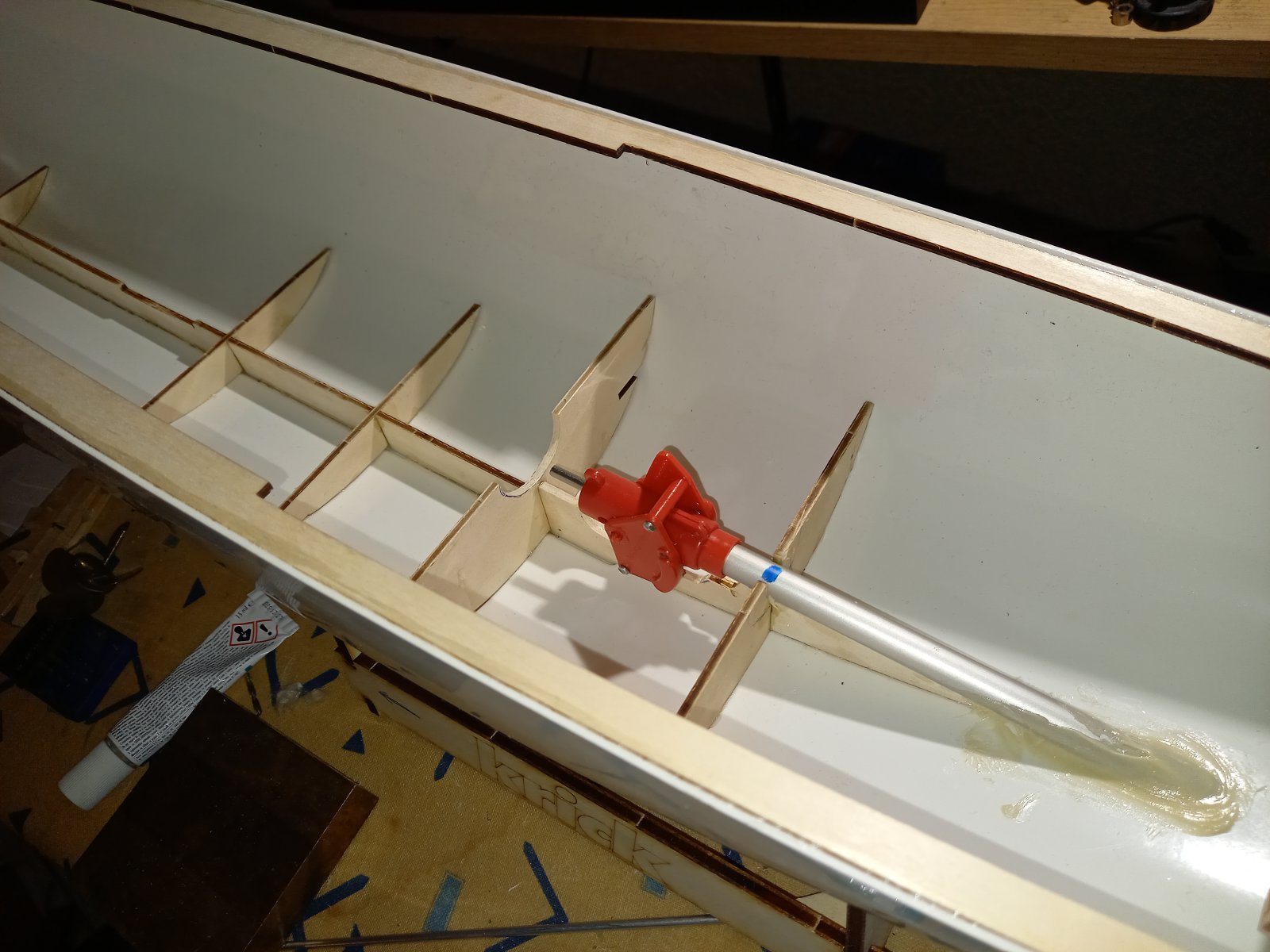

The "backbone" adapted to accept the Marx controllable pitch propeller and shaft:
Test-fitting the shaft on the backbone:
And the backbone glued in the hull.
It is getting late, so tomorrow continueing with fitting the propshaft in the hull.

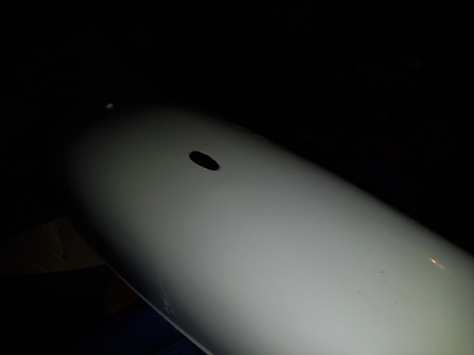

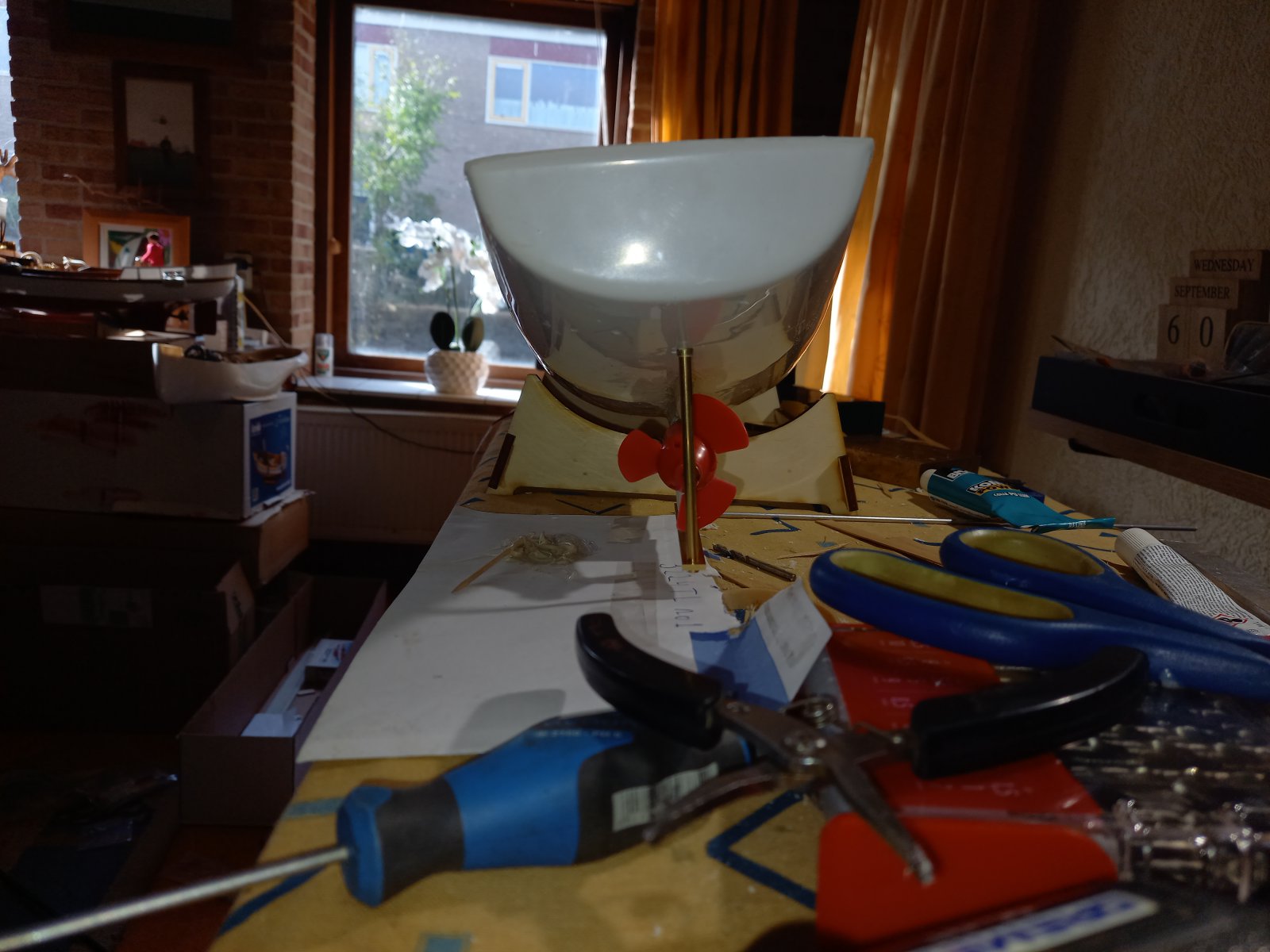

Giving the build another kick, today worked out the hole in the hull to pass the sterntube through:

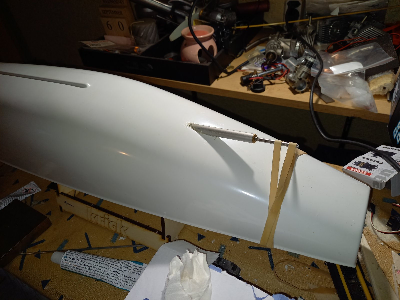

The sterntube assembly was located, marked and glued in
This is the first sign of "something is going to be different about this"...
and fixated:

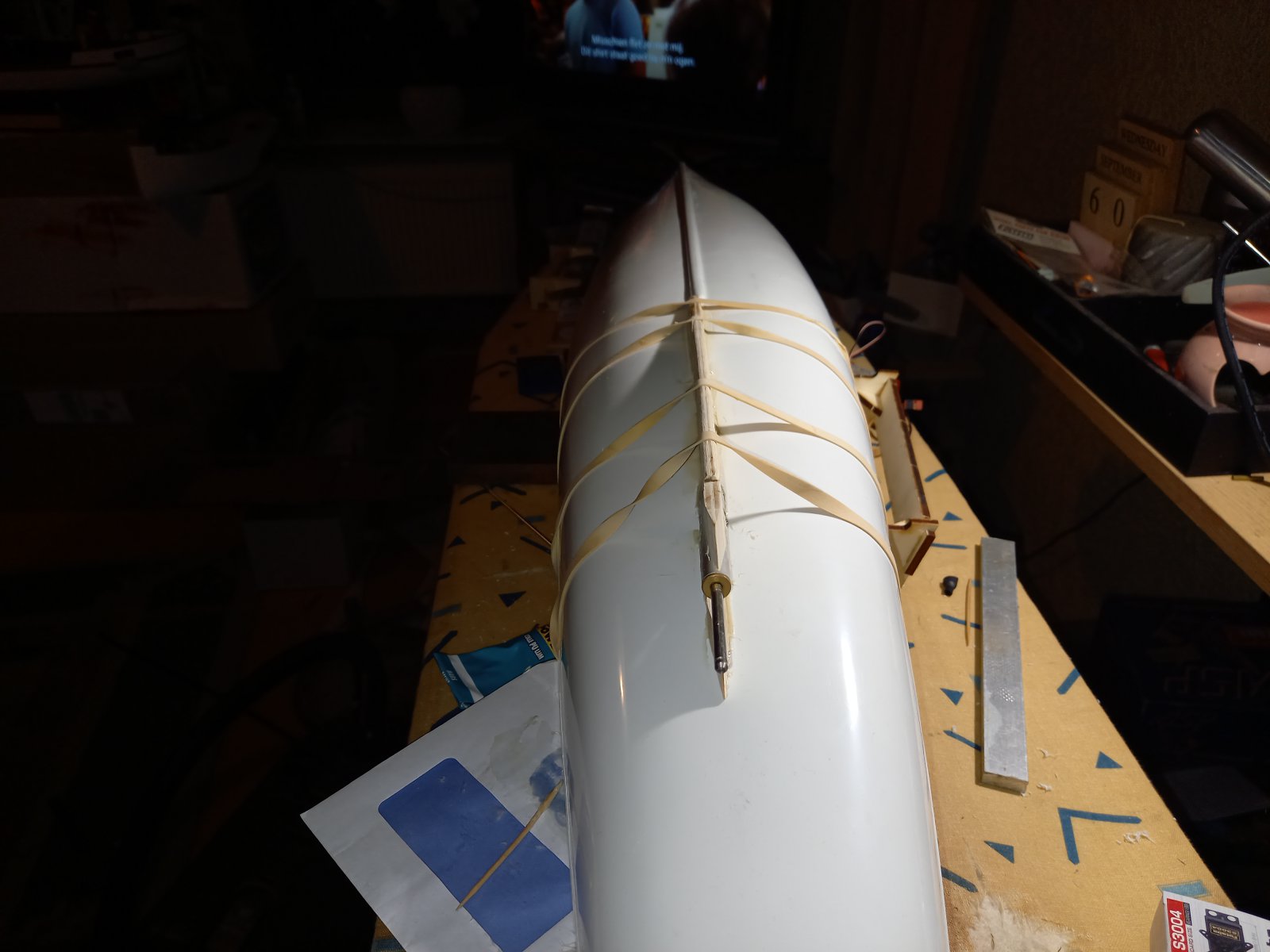

Glue used is Bison Combi Power PolyUrethane 2-component. I was told this to be the best option for ABS after Stabilit-Express (which is not easily availlable over here), but I am not too happy with this glue WRT handling. Stabilit is easier to get a nice and smooth result with
I'll have to wait for the glue to set before fitting and placing the fin.

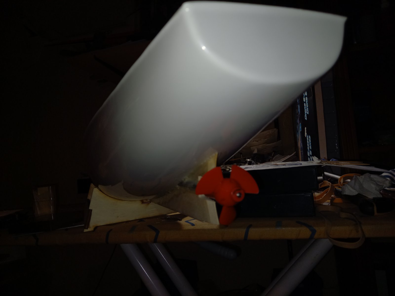

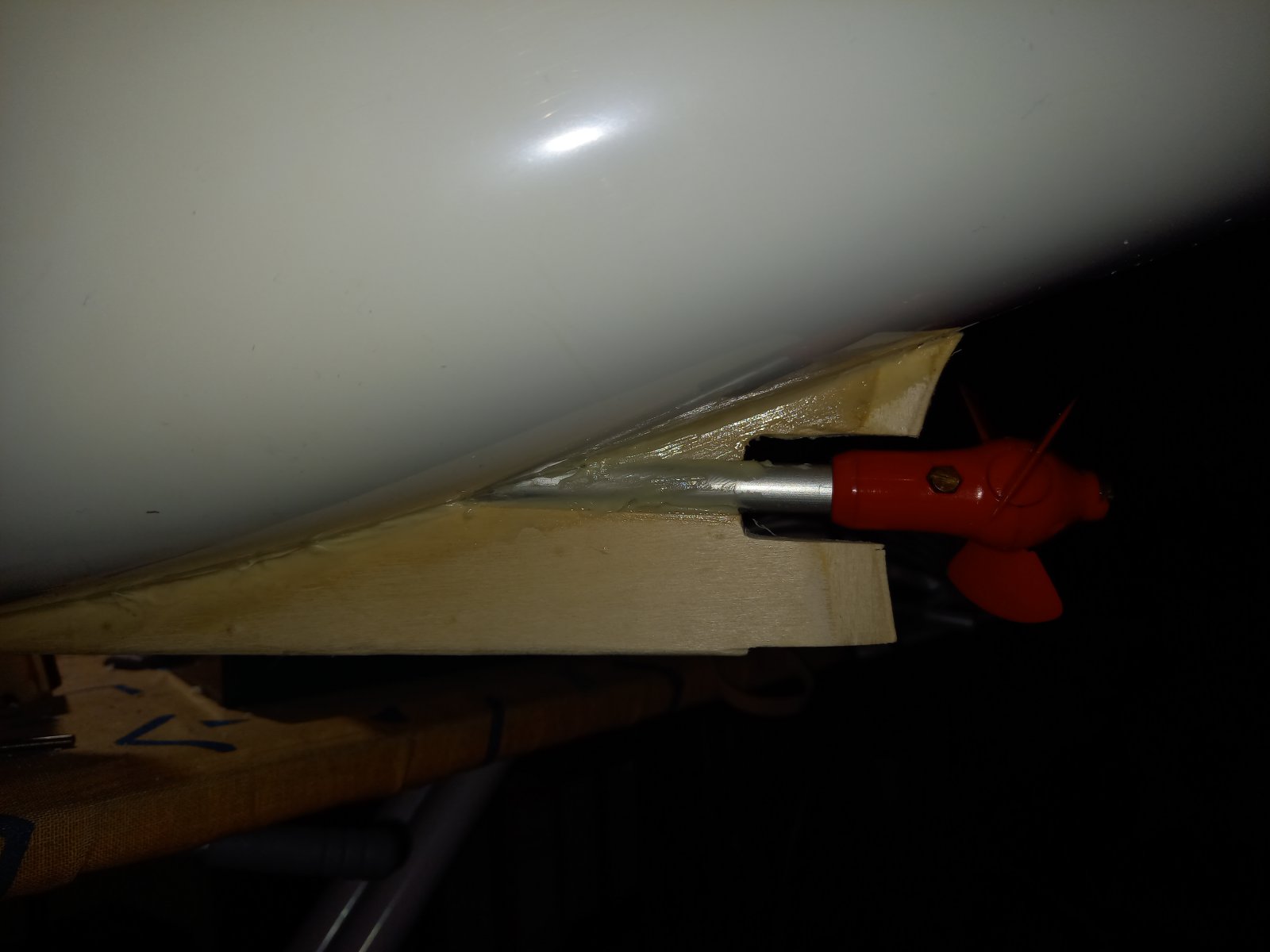

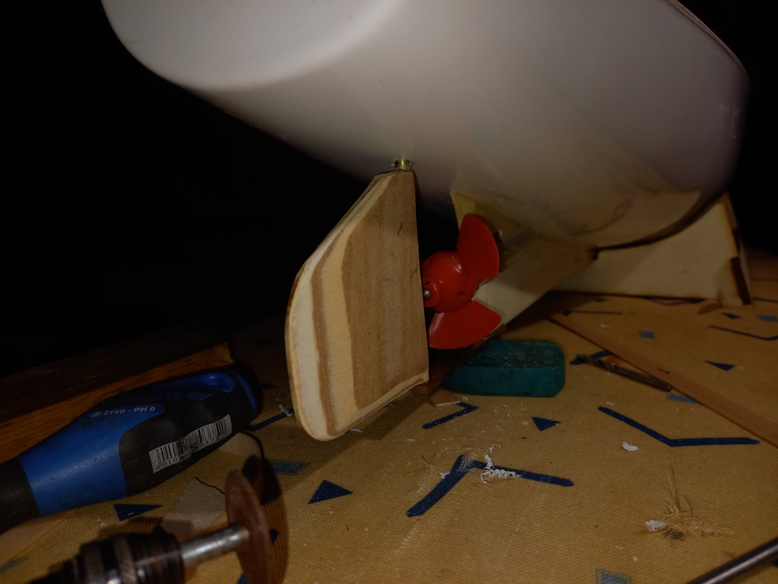

So... I glued the sterntube in, as centered and parallel as I could, basing myself on the "backbone" (which due to the laser-cut and symetrical frames SHOULD be centered and parallel, right?)
Well... when I placed the fin, it turned out that the inside of the hull does not 100% align with the outside... What is centered on the inside, turns out to be about 1 mm sideways of the center of the outside,,,
(note how the fin lines up with the keel of the hull)
But other than that, things seem to work out fine
Basically, here is where I have to start deviating from what the kit instructions say the order of assembly should be, because from now on I need to take the driveline into account, and that driveline does not only not yet exist, it also will most definitely NOT match the lay-out of the originally intended steam plant.

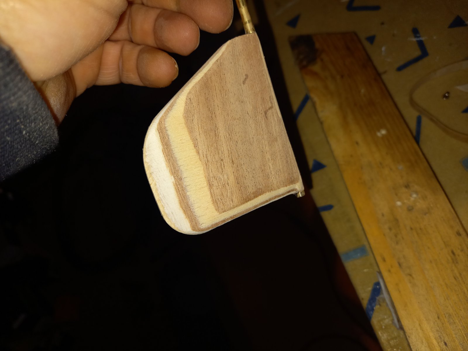

So... today the rudder construction was tackled.
Fitted the heel to the fin, aligned the rudderstock to determine the spot for drilling, and so I did.
Looks nice and vertical:
Looks nice and centered:

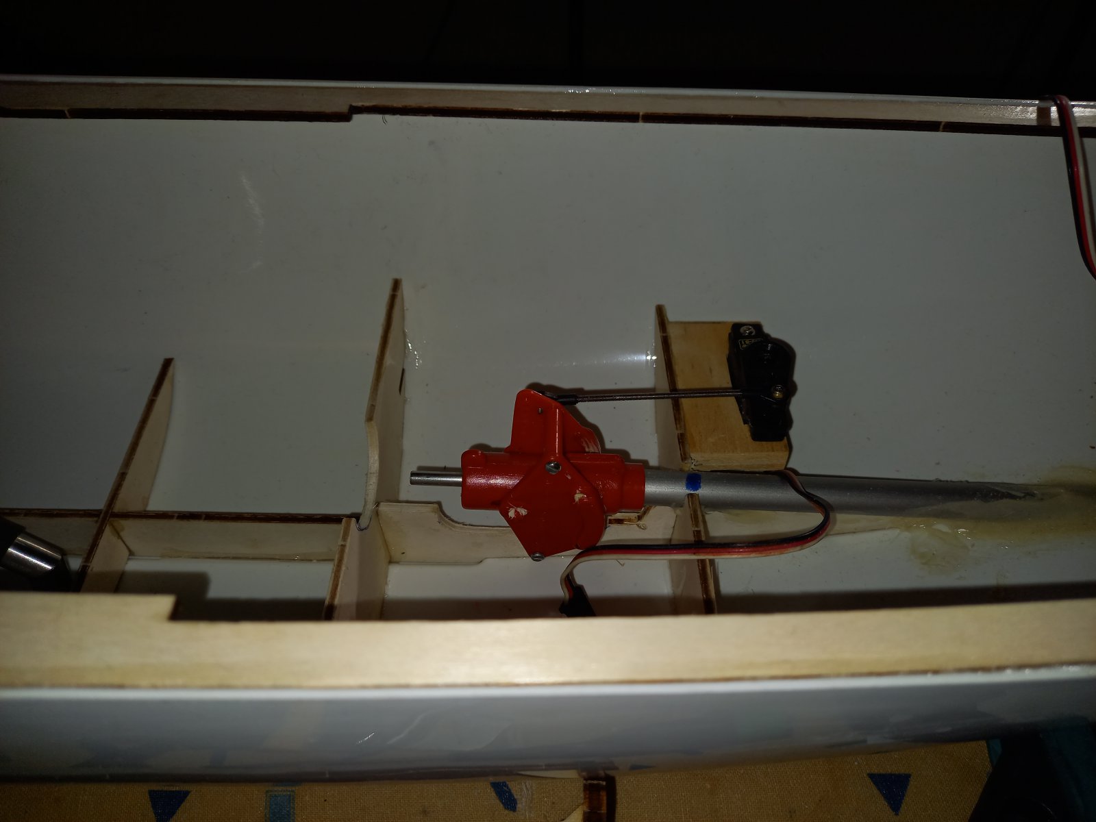

And then you look on the inside and:
Not in the middle... :( and I have no idea where this went wrong.
What I also don't like: THat deck frame is there according to drawing.
The rudder bearing tube is there according to drawing.
The servo mount is according to drawing, and still, that deckframe blocks virtually all portside rudder deflection, and the pushrod cannot be installed due to the frame being in the way.
The looks and style of this boat is pretty, the contents of the kit are decent if not downright good, but the design and execution are a bit poor to say the least...
Oh well...

Rudder done...
Of course the rudder will get a coat of paint, prolly a proper "antifouling-red" colour (no real antifouling of course, just the colour...
