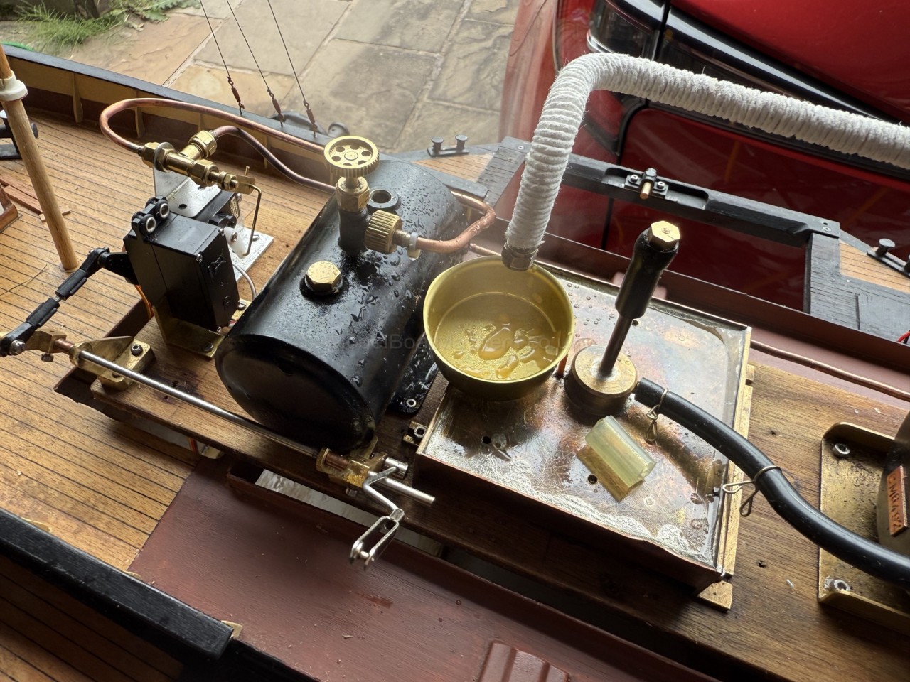

Finally time for the steamy parts. I did an initial trial fit of the steam plant as I receieved it. Some issues with blocks that had been glued into the main compartment getting a bit close to the burner. The gas tank was a nice snug fit in the bulkhead but wouldn't be easily removeable. Most of the plant was mounted on a wooden base that had been raised up on 1/2 inch high legs which I didn't really like as I felt it moved the centre of gravity upwards unnecessarily.
This is my first 'real' steam boat, I've dabbled last year with a Wilesco D48 in a steam launch but with no deck and access hatches that was a walk in the park compared to this. I very quickly abandoned the idea to put the items individually into the hull deciding instead to mount everything to a single removable base. So this is what I eventually settled on. The boiler position is pretty fixed by the funnel. The gas tank is removeable via the front hatch. The wooden block under the engine, is a placeholder for a large condensate tank I'm planning. Believe it or not this whole thing feeds quite easily into the hull. Not enough hands to get a photo or video of it so you'll have to take my word for it.
The gas tank arrangement took a bit of trial and error to something I was happy with. I wanted it to be easily removable to allow for filling outside of the boat. There are 4 M1.6 socket head screws in the wooden base that act as locating lugs. The tank drops straight down through the hatch without obstruction and then once it is almost fully lowered, you move it about 1/2 inch backwards to allow it to drop onto the lugs and then the gas pipe screws on easily. The gas valve was from Clevedon steam as it didn't feel right sailing without a way to shut off the gas remotely. The reason for the gas pipe being so long and convoluted was firstly to get it somehwere I could fit the gas valve whilst keeping the servo away from the engine. Primarily though it gives it quite a bit of spring and flex which was initially required to fit the gas tank past it before I figured out it worked better with the tank not aligned with the hatch.

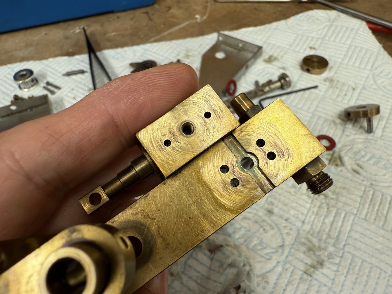

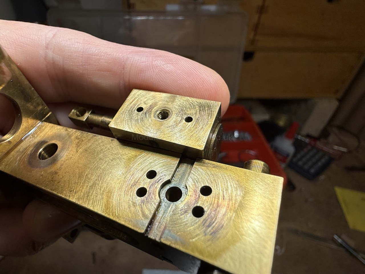

Hi All
Hoping to get some help and advice with an issue that has been driving me mad. It's a Cheddar steam plant in this boat and I don't seem to be able to go more than about an hour or so of sailing time before the port faces on the cylinders look like this.
I'm sure it must be lack of oil. I'm using the standard displacement lubricator that came with the engine from Cheddar. I decided to do a bit of a test by disconnecting he steam supply to the engine and catching what comes out. Firstly I just let the whole system warm up and then emptied and refilled the lubricator. Over 10 minues what I saw was 99% of the oil was discharged within the first minute. I then cleaned the pot to be able to see what came out over the next 9 minutes... and the answer was not much.
Minute 0 to 1
Minute 2 to 10
Do I have any chance of getting this working to get a steady oil supply over a 10-15 minute run with the current set up or could swapping to a different type of lubricator help? Currently it is just the standard Cheddar models one where the steam supply passes straight through, I was thinking I might be better off with the type the hangs off the side of the pipework with a regulating valve... like this one https://maccmodels.co.uk/shop/live-steam-fittings/lubricators/displacement-lubricator-5-8-dia-3-16-x-40-2/
Any thoughts?

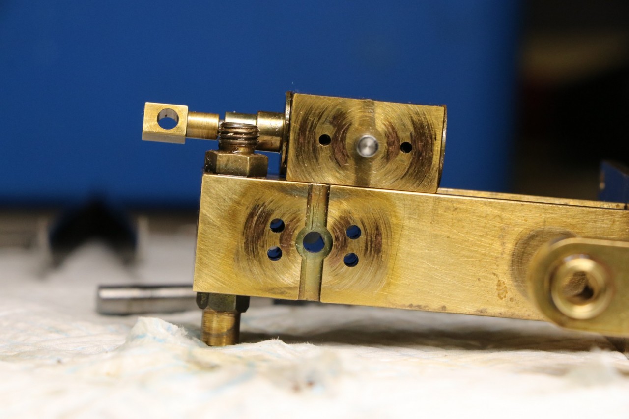

Some very wise words and questions from KBIO, I could only reinforce the comment on Keith Appleton........[I subscribed to his WEB pages @ $1.00 per month for over 3 years]
The visual degree of radial scoring shown to the Cheddar horizontal twin engine piston faces and standard appear significient, however any attempt to hand linish these scored faces has the potential to make them usless <*< >>:-( unless absolute flatness and angular relationship [thru 360 degrees] is maintained to the bushed bore in the cylinder and the fixed bore in the standard
