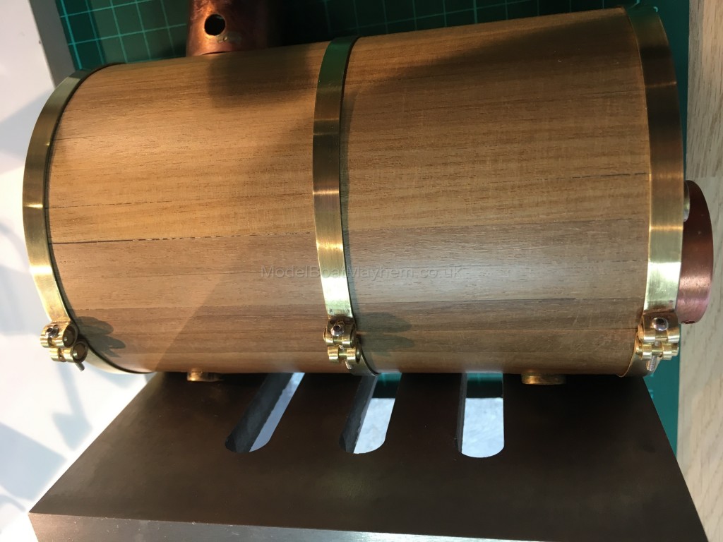

You will find it easier to fit the lagging with either tape or elastic bands first then deal with the banding when the lagging is all in place.  You need to be very careful when drilling the end of the banding because the plate is relatively thin and the drill can snag easily.  The end must be securely clamped.  I've attached a couple of pictures of a boiler I did.

I did mine like this
But also get some ceramic lagging underneath the planking as this will help keep the heat in.
