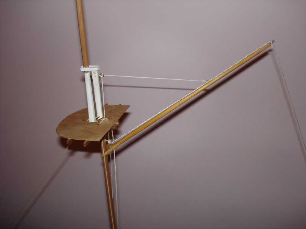

First things first - our baby boy was finally born on the 18th of this month. Both he and his mum are doing well, and our home is fuller and busier than it has ever been.   :-)
Just as importantly (at least in this forum), in the lead up to the birth, and the subsequent time off work, I have actually managed to move Lialeeta forward.
Very briefly, I've finished the deck (1mm ply, planking drawn on with a black ballpoint pen, stained with mahogany and varnished - not yet mounted), mounted the rudder and winch servos (and I think managed to make a reasonable fist of JayDee's box - see pics), installed the stanchions that will eventually be planked and become bulwarks (I'll have to fit the deck first, or I strongly suspect it won't go on past the bulwarks), made and installed chain plates from brass rods, cut the mast steps from aluminium tubing and cut the masts themselves (these are from strong, straight Tasmanian Oak Dowel - seemed apprpriate on this vessel), and cut the bowsprit and fitted it with my own brass hand-made mastbands to hold the stays and bobstays.
All up I'm feeling very satisfied with myself. I'm ready to fit the deck, paint the hull, build cabins and hatches and then start rigging her up.
Just wanted to refer a few things to this august forum.
1. As you'll see from above, the winch servo and running rigging will be sited above the decks, not below as I had orginally envisioned. I've searched the forum but not really been enlightened on the subject of tackle for running rigging.
- I know I can buy working brass blocks, though they are pricey-ish. Are they worth it?
- Some people seem to use conduit tubing from garden watering systems and such - doesn't strike me as an above-deck solution...?
At this stage I am planning to use brass eyelets, screwed into the timber frames, to run the sheets around the deck. Does this sound workable? Other ideas?
2. Water-proofing the hull at the deck join seems tricky. I've decided to run a bead of clear bathroom silicone around the join, then screw the deck down to the hull frames on top of the silicone. That should do the trick, right?
3. The hull is wooden planking, filled here and there with car-body filler. For the painting process I'm thinking:
- coat of fibreglass resin (I dunno...seems like a good idea for strength and water-proofing)
- couple of coats of primer
- 3 top coats of enamel spray paint
Your advice and ideas on issues at 1, 2 and/or 3 most welcome.
And that's where I'm up to. I'll pop a few pics on for you to see how she's looking too.
all for now, Glen

1. As you'll see from above, the winch servo and running rigging will be sited above the decks, not below as I had originally envisioned. I've searched the forum but not really been enlightened on the subject of tackle for running rigging.
Yes, I would use the working blocks as a nonworking solution will cause the line to fray and eventually break(usually at the worst possible moment  >>:-().
Yes it sounds like it would work it just may not look right or properly finished, if it was my model I would wait a couple of weeks till I could afford the proper fittings so it not only worked right but looked right on display.
2. Waterproofing the hull at the deck join seems tricky. I've decided to run a bead of clear bathroom silicone around the join, then screw the deck down to the hull frames on top of the silicone. That should do the trick, right?
Yes it would, but since this is a sailing model and you will not need to get into the hull spaces I would glue the deck to the frame with epoxy, as a sailing model it may have one or the other of the rails in the water as it heels over. Since all of your servos will be either in a deck house or under a deck house there is no real need to have the main deck removable.
- coat of fiberglass resin (I dunno...seems like a good idea for strength and waterproofing)
I would also put a coat of resin on the inside of the hull to prevent water from soaking into the wood from the inside, if the planking gets wet either from the outside or the inside it will still expand and eventually crack the outer finish. I also coat the underside of the deck before I glue it in place just so there is no raw wood there either .
The winch will drive one or more closed loops - these need to be turned round somewhere.  The ideal is a working pulley, preferably in a scale-like material and construction.  The minimum is a brass screw-eye with the loop cord running through it!
I wouldn't go for eyelets - they are sharp one side and will eventually fray the cord.  Given the universality of Murphy's law guess where the boat will be at that moment :}. (will it be upwind with a calm sea?)
I would (modestly) suggest that however you plan to finally run the running rigging; first use a working (simple) layout to get experience and iron out the challenges.  If you are feeling very sensible making a jig out of scrap that mimics the full-size layout will add to your self-confidence.
I made a big brig rig jig to do this - it convinced me!  (BTW I had a 1-turn winch which produces a travel of 4 inches (100mm))
Fwiw for Volante I am splitting the difference and making two pulleys using my kitchen-table methods and I expect them to pass muster for function and appearance.
I will sketch and post them later - alter materials, techniques to suit your stock bin and skill set
I realise I am assuming a closed loop from the winch drum with your sheets attached to the sides of the loop.  It is possible (but not enormously easy to get different travels for various sheets)  Much simpler to accept same travel on all sheets, and adjust the point of sheeting (esp on the booms)  to work with that travel!

Oops, to clarify, I actually meant screw-eyes, not eyelets. The more I reflect, the more I am inclined to go with screw eyes. I realise that they won't look scale, but then I'm not aiming for full detailed scale finish to display standard. I'm really interested in something a bit more straightforward than that, that will sail well and look good on the water. I'm taking inspiration from a yawl at my club which took a similar approach and looks great under sail. So I have some small screw eyes that I've primed and finished in black so they don't stand out too much.
As to running rigging - I'm not planning to use a closed loop, but rather just sheets that wind on and off the drum - if you know what I mean. All sheets will travel the same length, again for simplicity's sake (though I like the idea of fixing to different parts of the boom to adjust travel, thanks Andrew). There is a part of me that is toying with fixed foresails - that is, set up to travel on a horse, but not actually rigged onto the winch. I wonder whether this is possible or desirable?  Just thinking out loud...
amdaylight - thanks so much for your thoughts. I've now thoroughly coated the inside with resin. Ain't no water gettin' in or outta there, I can tell ya. I painted the underside of the deck with timber sealer, as I thought resin would crack when it came time to fit the deck, due to the high degree of sheer. I'm going to go with plan (a) and use silicone, but only because I had already bought some. I guess I was just testing the water in case anyone said 'Silcone!!! Whetever you do DON'T USE SILICONE!'. Which happily didn't happen  :-).
Andrew - what can I say? "big brig rig jig" - you're a genius. I'd be interested to see some more detail on the way you've fitted topmasts there, as it's something I'm thinking about at the moment too. Was thinking of making a wooden platform (maintop?) similar to what you have there, or maybe even attempting something from brass tubing. Dunno. Also, how have you fixed your bowsprit? I've screwed mine onto the actual deck, but I'm worried that it still won't bear the load. I might fix it onto the stem as well, I'd like to hear what others have done.

« Reply #43 on: November 13, 2008, 05:23:24 pm »
Glen,
Sorry about delay, but you were no doubt changing a nappy anyway
With a sail winch I believe you need either a closed loop OR elastic tensioners to avoid the dreaded buggle round the drum - right out in the tasman sea as well.
The  winch needs a little tension kept on the line it is winding - I have seen this done with fishermans pole elastic - just to keep a light tension on the line.  JayDee has wound more sheets on his drums that politicians tell "statements of variable accuracy"
My "tops" I did like full size.  Trestle trees were cut from 1/8 ply including the cheeks which fit aslongside the mast, and the cross trees coffee stirrers.  The Top is 1/32 ply with drawn planks.  Where scale and I part is that I have screwed the trestle trees to the lower masts through the cheeks of the trestletree (I needed screweyes there anyway for the braces :})
The mast cap is a bit of satsuma ply (salvaged from orange boxes) with a square hole for the top of the lower mast.
Top mast is also retained by a screw - very fine self-tapper salvaged out of dismantled computer drives
Couple of pics - let me know if you would like to see anything specific
foretop
maintop with gaff
One of the topmast doublings - not complete - the trees are missing
andrew
