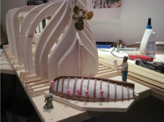

Hi there, I have made many a lifeboat for model tugs and various other models - using the simple method of tracing onto very thin plywood  - the outline shape of the lifeboat & the plan view and gluing balsa blocks & sanding & shaping them to the correct shape.   The only images I have of this method is on a build which I did years ago - HMS Daring.   This shows how I made the boats for her.   Like I say I have used the same method for the Cervia Tug lifeboats and also the Frederick Spashett build.   Here are the links to these:

This is a good plan that can be hacked around and adapted.
https://www.skipper.co.uk/catalogue/item/ships-boats-smacks-dinghy-or-beach-boat
Both these boats were made from it:
