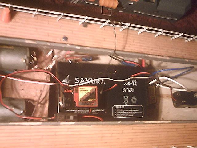

Bob  to save all the questions of where is such and such any chance of a picture of the inside ,sometimes something stands out.
Peter
If its Bobs Scheutze I have a picture of the inside.
Richard ;)

Okay heres a picture of the set up
each motor has 3 suppressors, reciever on the battery with ESC further up towards the bow with the RX battery pack.
Jay

Have you tried moving the receiver away from the battery.
I was thinking, all that lead and power drain by motors sparking !! etc.
Just a thought.
Cheers...Ken

We tried with the reciever right at the back and the ESC right up in the bow but it didnt make any difference.
Get this, ive taken the same RX and ESC out of my Schutze and put it in my baby Seven and all works fine ??? distance checked and well i walked all the way round the large lake in Whiteley without any problems or glitches from the radio BIZZARE.
Jay

Is that a metal railing around the deck ?   Anything 'differrent' about the build ? Iron filings in the gelcoat ?
Try the RX on deck with the Ariel vertical.    getting desperate now.   ;D
Cheers...Ken
