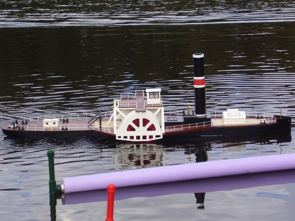

Here is my old beastie
unfotunately i cannot find any piccies where i showed the motor and as i have sold it i cannot take any more. it was a lot of fun but too heavy for me and my bad back 25 kilos was the running weight she was 1.5 metres long and had 5 divers weights strapped inside for ballast

steamboatbob   any chance of a picture of the steam plant.

unfortunately no as i have sold it to a guy around 4 months ago and i cannot find any photo's of the plant it was a homebuilt one from my dads workshop twin piston single boiler if that is any help
