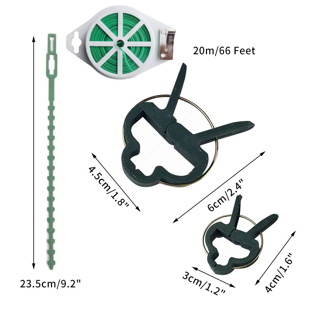

Those small clamps look to be pretty good quality. I've got some small ones where the grips/ends keep breaking and dropping out. One of my next builds involves planking so need some decent ones.
Where did you get your pins and tool from?
Build is looking great and I always smile at all those holes!
Chris
Thank you. I bought from CMB
The clamps are Wolfcraft. When I bought the first lot they were nearly £1 per clamp and I thought that was good. To get 6 for £2.06 is crazy
I have the same Amazon / Wolfcraft and yes the end bits do keep falling off!
... try a tiny drop of PVA or flex glue.    :-))
I was hoping that the ends didn't fall off those! They look to be better than the black and orange ones I have left (after binning some) so have ordered some for my increasing clamps supply!
Chris

The tips on the Wolfcraft clamps will come off if they have glue on the clamping face but not break off and can be re attached. . They are designed to swivel so they stay parallel to the surfaces at all thicknesses. When gluing the way I am they stick to the Aliphatic resin but if you swivel the clamps side to side it sheers any glue before squeezing the clamp to remove.

That's good to know, because like you I've ordered 30. The tips coming off won't be a problem, with my others (bought from one of the shows so expected better) the pins were breaking off, even before being used sometimes. I've got some of the bigger ones and they are better but they tend to be last resort clamps as I've got better.
