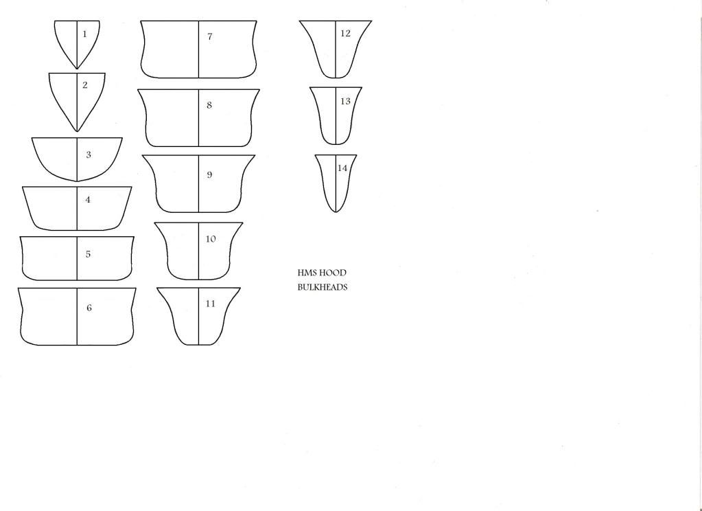

« on: April 04, 2009, 08:51:14 pm »
On going to the local modelshop i picked up an Airfix kit of the HMS Hood.
after getting home i thought wouldnt it look better if say it were 7 foot longer ? ? ?
so out came the pencil, measuring tape and paper and jotted down dimensions, etc etc.
took a while to work out a profile of this vessel, and after lookin on the net with no joy (other than having to pay to have plans) i decided i would draw my own, this wasnt a problem as have built many model flying aircraft in the past in this way.
after measuring the kit i came up with a model that would be 7 ft 1 inch long,
after drawing the profiles on paper i scanned them onto the trusty laptop and traced the lines and reprinted to the actual size that i required...the magic of technology
so today i have started the build and will show my progress as i go through
thanks,
Rob

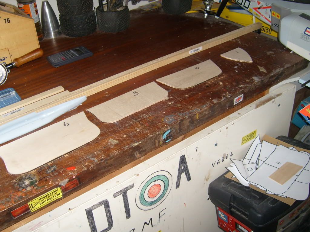

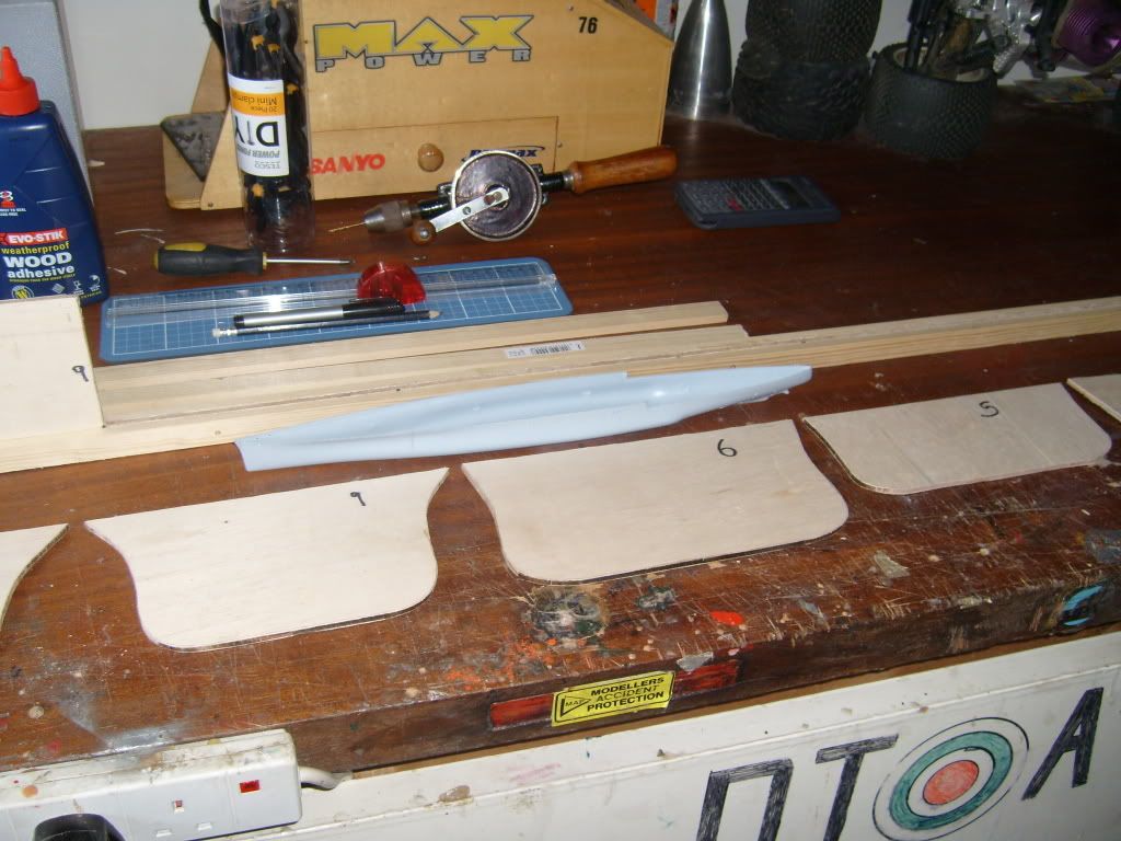

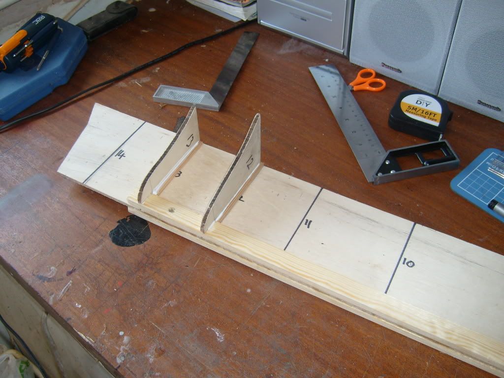

MGrob
Re: HMS HOOD - MGrobs BUILD
« Reply #4 on: April 05, 2009, 10:23:46 am »
just took some quick pics, sorry but not wide enough lense  :-)
more later........
Rob

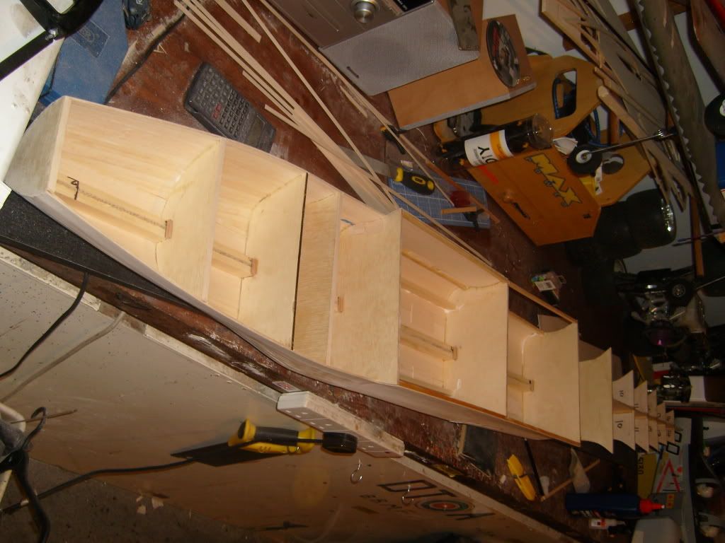

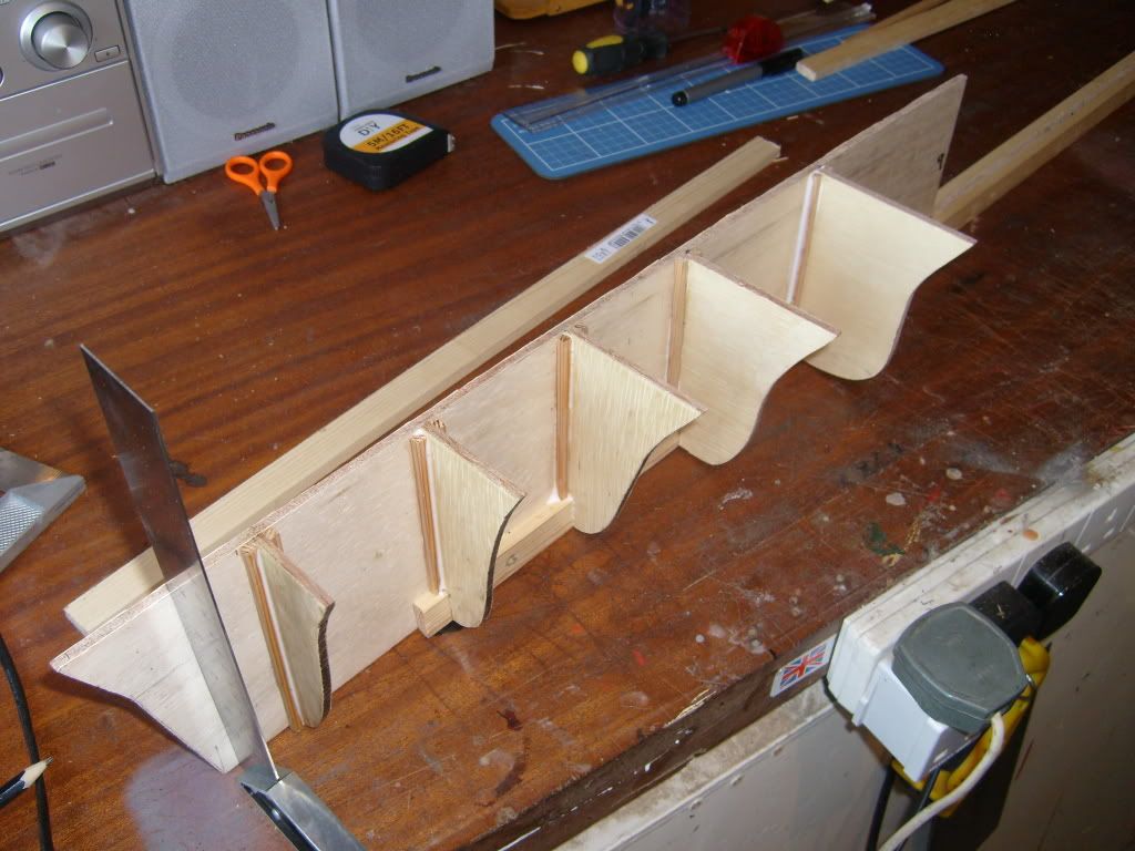

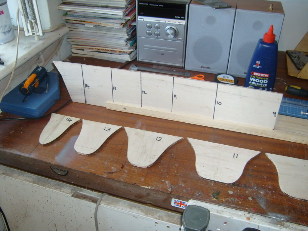

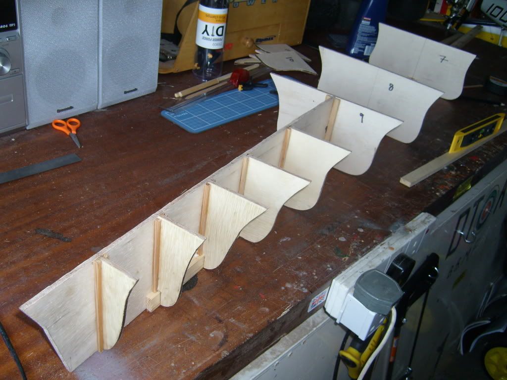

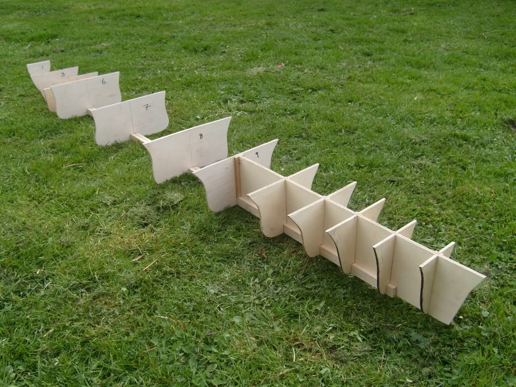

MGrob
« Reply #5 on: April 05, 2009, 04:10:37 pm »
some more pictures:
Rob

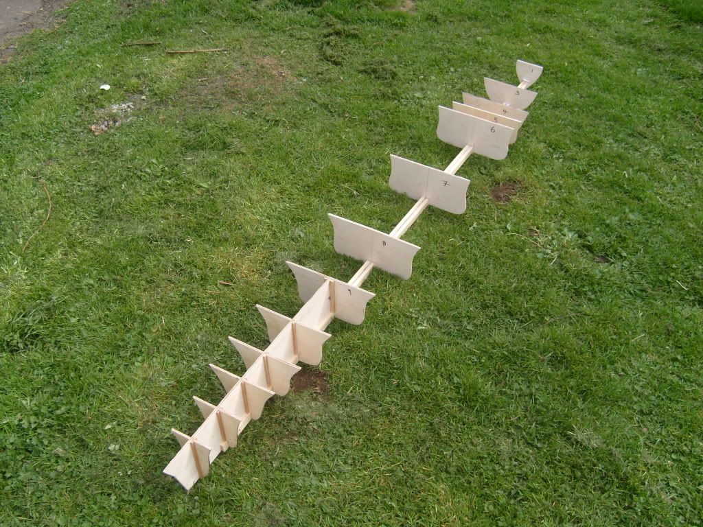

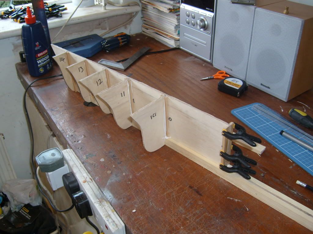

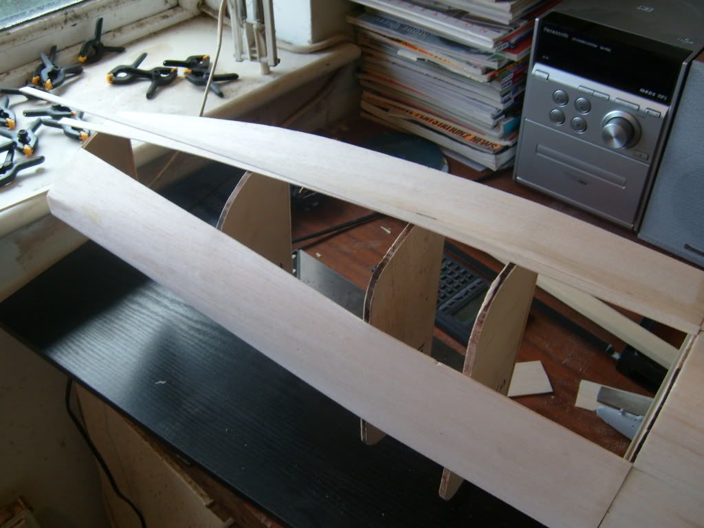

MGrob
« Reply #6 on: April 06, 2009, 01:02:08 pm »
Hi all, late night last night, wanted to get all bulkheads done.....
certainly lookin ship shape....no pun intended  {-)
not long to skinning to hull, cant wait
Rob

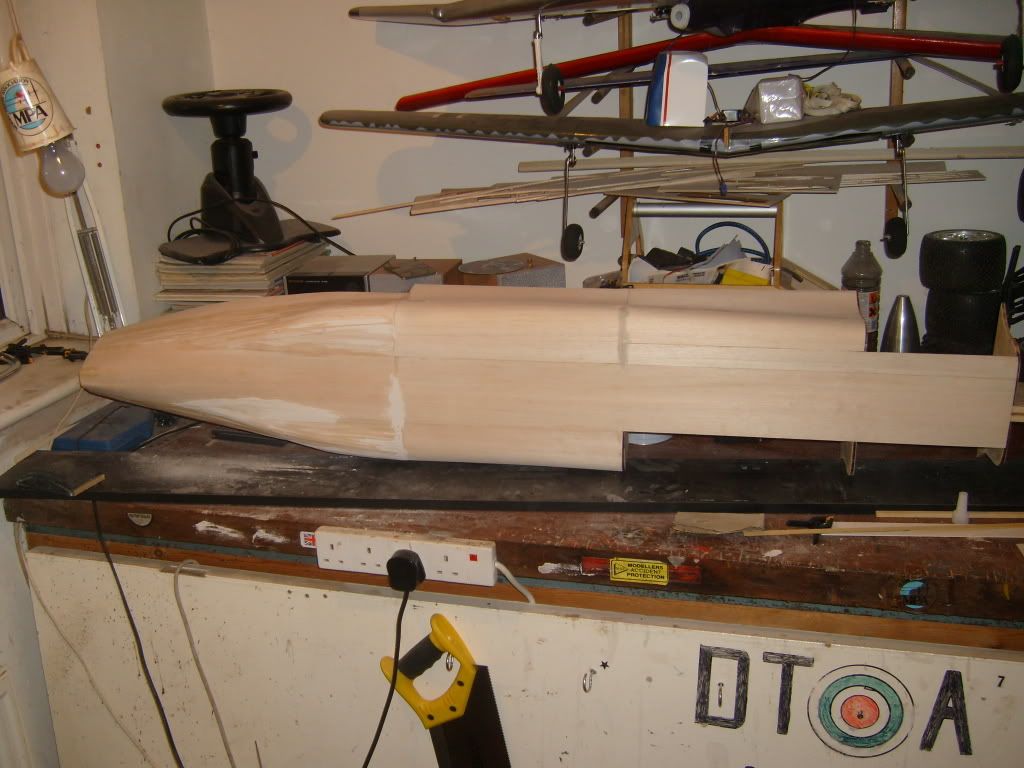

MGrob

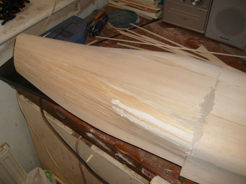

« Reply #14 on: April 11, 2009, 12:53:44 am »
Update
More planking and sanding and filling and sanding and filling and planking and sanding blah blah blah .......  %%
Rob

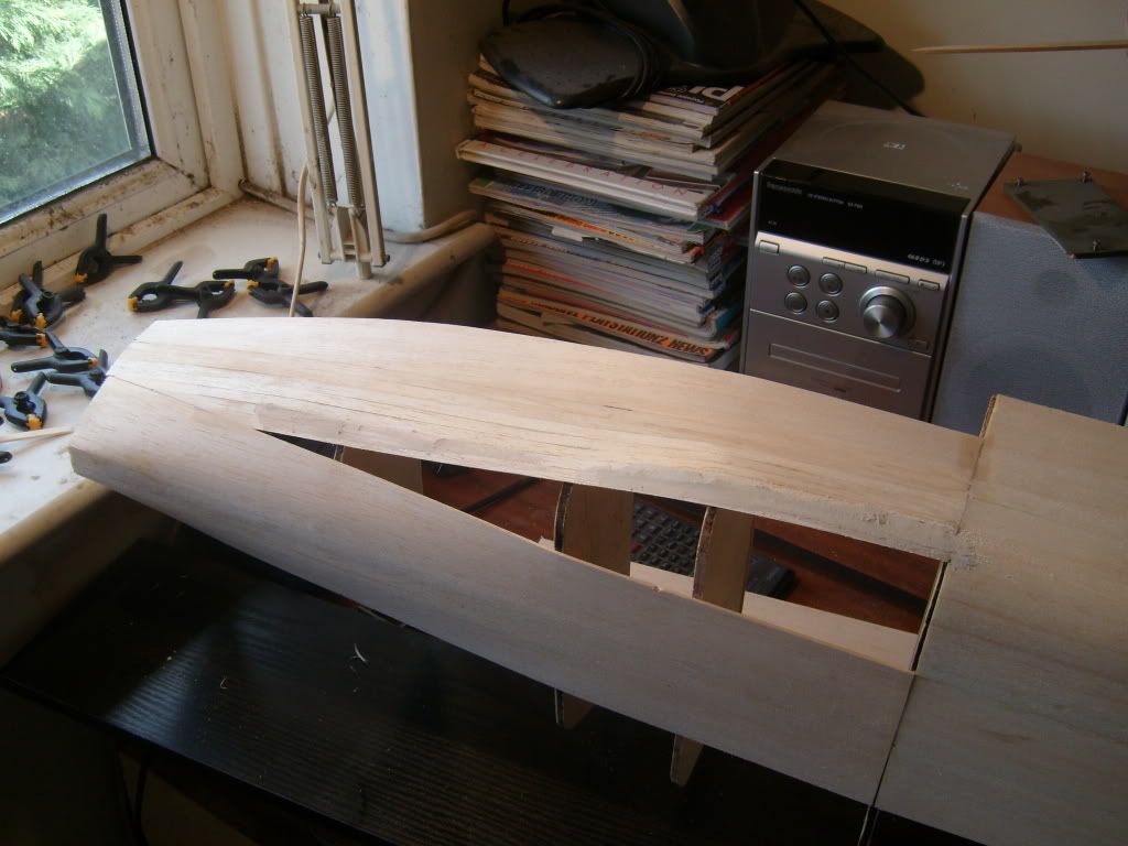

MGrob
« Reply #17 on: April 11, 2009, 07:33:09 pm »
Rob,
What's your plancking material?
Mark
a combination of light ply, and odd bit of balsa, then fiber glass on the inside...
and as for the workshop, was tidy when i started, but then just got messy but strange thing is i know where everything is  :}

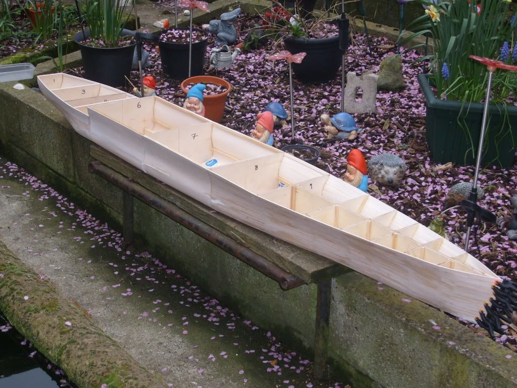

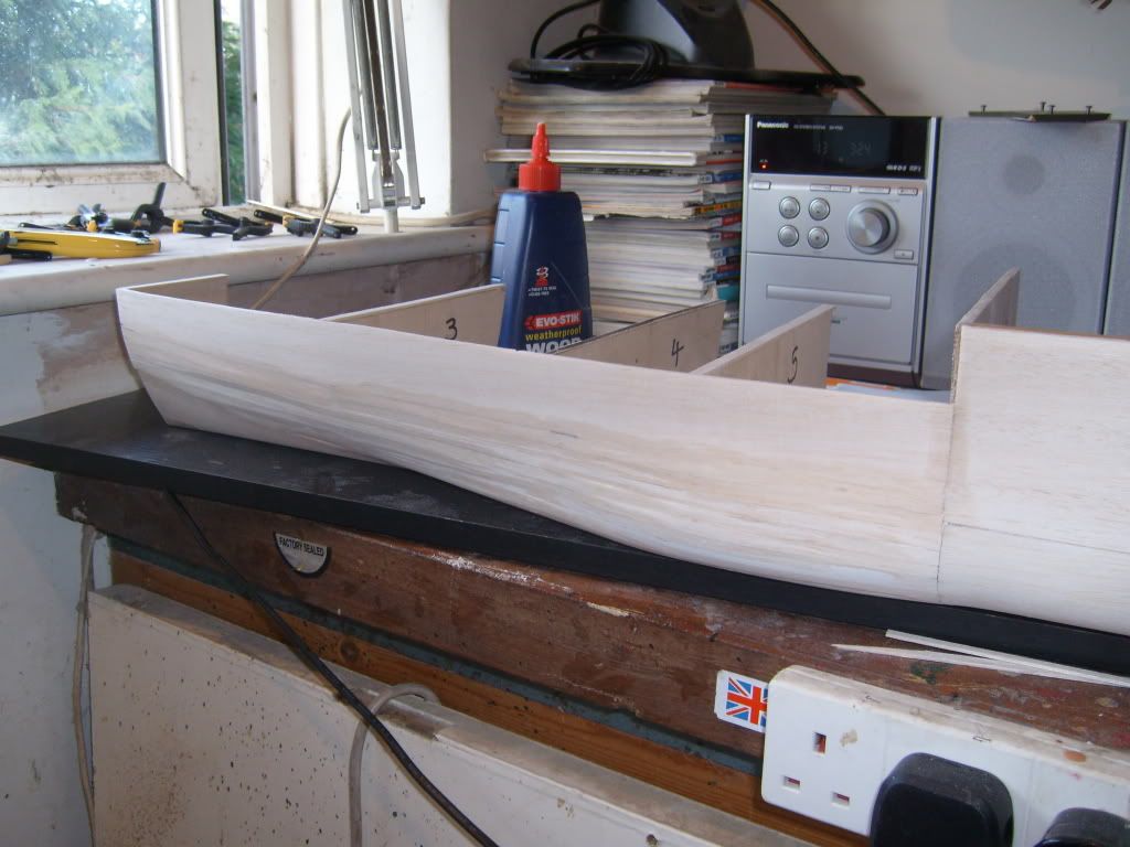

MGrob
« Reply #18 on: April 12, 2009, 06:25:19 pm »
one more picture, before all the finish sanding, and before the 1st layer of primer goes on....
just noticed also that all the gnomes have come over to have a look  {-)
Rob
MartinH-K
« Reply #19 on: April 12, 2009, 07:04:23 pm »
Probably a stupid question but I notice the stern seems to be squared off. Are putting it on seperately? I mean... you're about to give it its first primer coat... {:-{
MGrob
« Reply #20 on: April 12, 2009, 07:10:02 pm »
havent yet stuck it on yet, i did this part in block and shaped it that way
good observation tho, will be doing the spraying when weather gets better again, easter weather always the same  {-)

MGrob
« Reply #22 on: April 13, 2009, 12:48:23 am »
way ahead of ya, started fibreglassing earler this afternoon, love the smell it gives off but the nagging of the other half  {-)
planning on spraying next weekend if all goes ok, more pics to follow once more has been done
