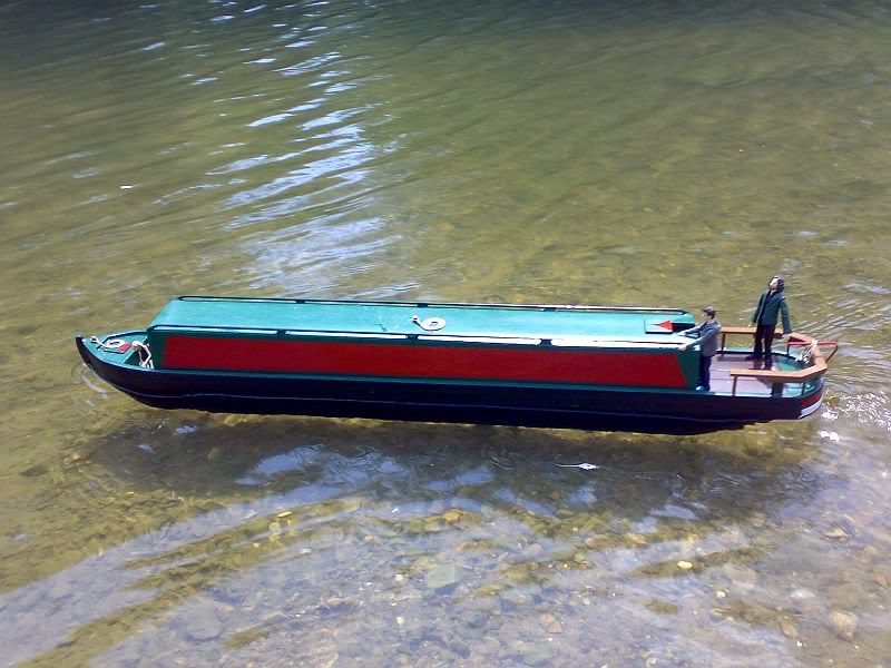

I finally managed to get my narrowboat on the water today - still some details left (like windows and roof details) but she floats and runs well

1:20 scale, scratch built.
36" long 4"wide 3.5Kg running weight 385 motor on 7.2volt pack

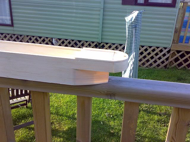

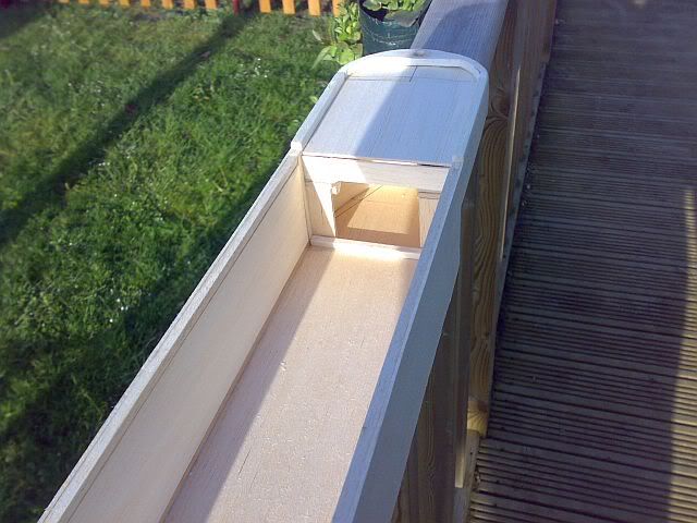

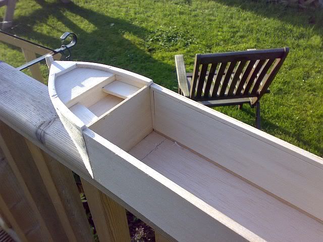

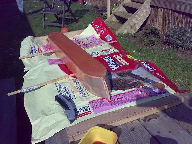

Found a couple on my eldest sons phone
bare bow
2 views of bare stern
fibreglassing the basic hull
I'll try to find more next time I see him

You might notice that below the waterline she is not to scale
unfortunately, where it can't be seen she is approx twice as deep as full size in order to accomodate a 35mm prop (and make it more stable). above the waterline the scale is reasonable
