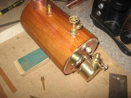

Andy,
       the Cheddar Models method was to spray the whole boiler with black heat proof paint and then glue the wood lagging on using cyno or epoxy. The brass bands were then fitted to help retain the wood.
Hope that helps.

« Reply #14 on: November 29, 2009, 10:26:21 am »
Cheers, was wondering how to hold all the wood on and tighten the belts, alltough I thought of glueing the wood to light woven fibre glass cloth and wrapping it around the boiler then brass band to hold it on. May still do that to stop the boiler getting covered in cyano or epoxy, use cardboard tube for a former, then transfer to the boiler.

« Reply #15 on: November 29, 2009, 03:15:04 pm »
You could try double sided tape as per the MH&B instructions for my Topaz, worked well on my boiler.

« Reply #18 on: November 30, 2009, 12:50:13 pm »
I recently fitted insulation and wood to a boiler for the first time and spent ages wondering how to do it. In the end, I realised the easiest way for me was to cut out the lagiing, hold it on the boiler with elastic bands, then cut and fit the wood under the elastic until all was ok.
I then fitted the brass bands and tightened them up to hold wood and insulation in place - no glue, no paint, seems to have worked so far. :-))

« Reply #19 on: November 30, 2009, 03:39:25 pm »
Thanks for all your tips, I have glued the wood on with superglue, and when it is varnished I will add the bands, apparently when the boiler is steamed, because of the heat and expansion, the superglue will come off the boiler, leaving the planking held on with the bands. I thank Mike Abbot at Maccsteam for this tip.
