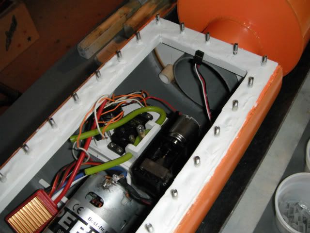

Making the WTC and the main ballast tank. The pipe going through the tank is for the trim tank.

This is what I've been up to lately. I'm still working on the WTC and also made the bow planes mechanism! This is my second attempt and it's based on the original plans of the real thing! Works a treat!

Progress is really slow due to other obligations but getting there! Finished with the WTC and it was tested for water leakage! Passed the test so I've started putting in all the bits and pieces and also I've installed the prop shaft and prop! Here is some pictures and a video!
