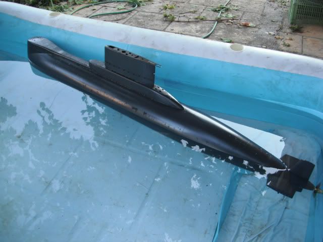

Solved the problem with stability and started triming the beast! Also tested all the systems and they work as they should! By the looks of it I'm going to need about another six pounds of lead ballast to bring her on the correct water line! See how it goes! More to come!

Some more trials today and everything works just fine! She stands on the corect water line now and only needs some fine triming wich I'll do on Sunday I hope! Photos and videos attached!!!

Some more pictures and a video of the triming stage in a proper pool this time!

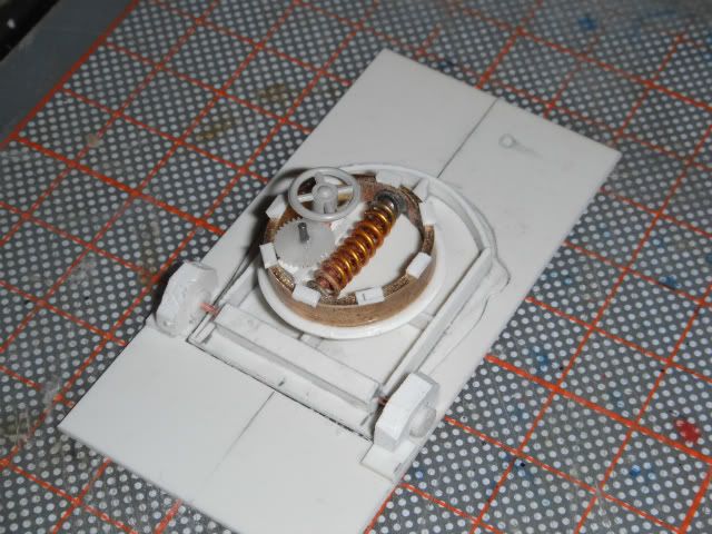

Did some more work adding more details and correcting the hand rail on the sail. Not quite finished yet but here is some pictures!

That watertight deck hatch is simply stunning work -- you continue to amaze!

Superb Yannis...absolutely superb workmanship.
