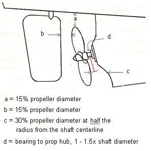

Found this the other day which someone may find useful.
Re: Prop Aperture
« Reply #1 on: November 19, 2010, 09:51:56 am »
Interesting but it doesn't give any recommendations regarding the size of the rudder.

« Reply #4 on: November 19, 2010, 01:15:11 pm »
This one shows some relationships for rudder to prop
