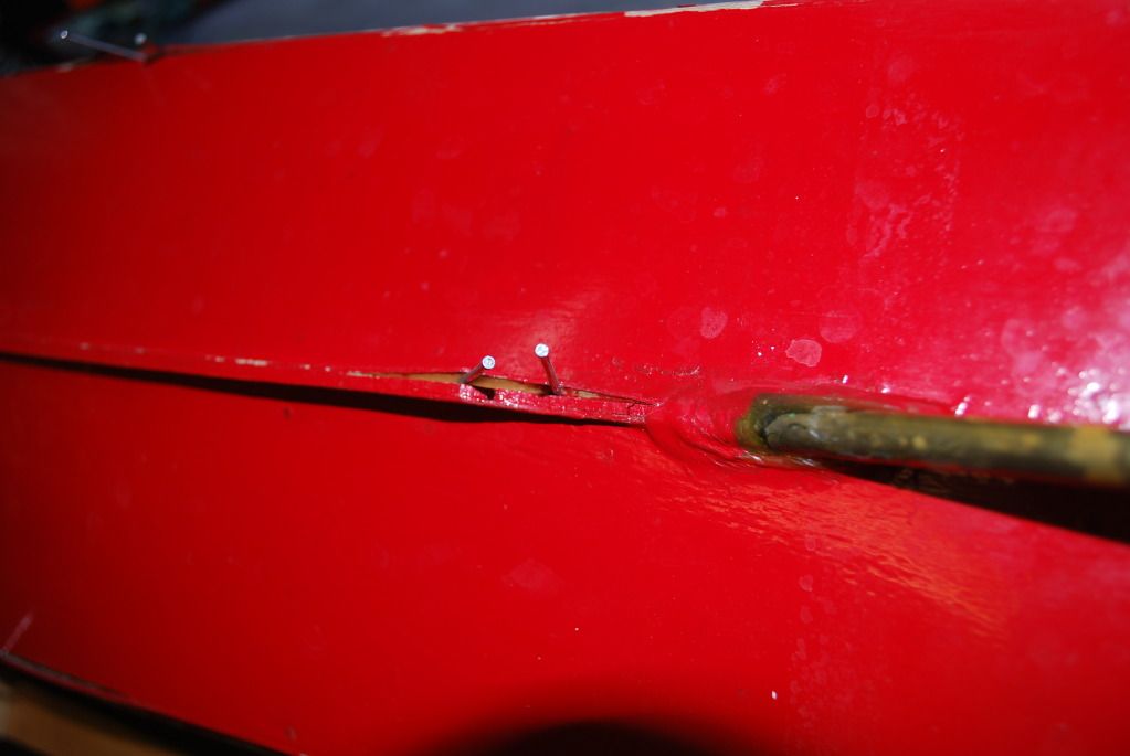

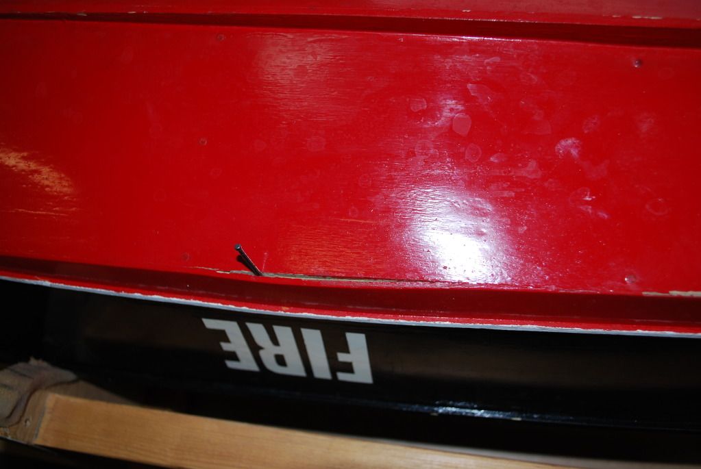

Hello all repair experts (I hope)
My beloved first boat -Fireboat - is starting to come apart at the seams[IMG]
after sailing over the summer.
I hope the pictures show the damage clear enough.
How do I go about sorting out this  deterioration in the seams / joints?
I have neglected to pay attention to routine maintenance so it seems.
Any advice would be most welcome and helpful.

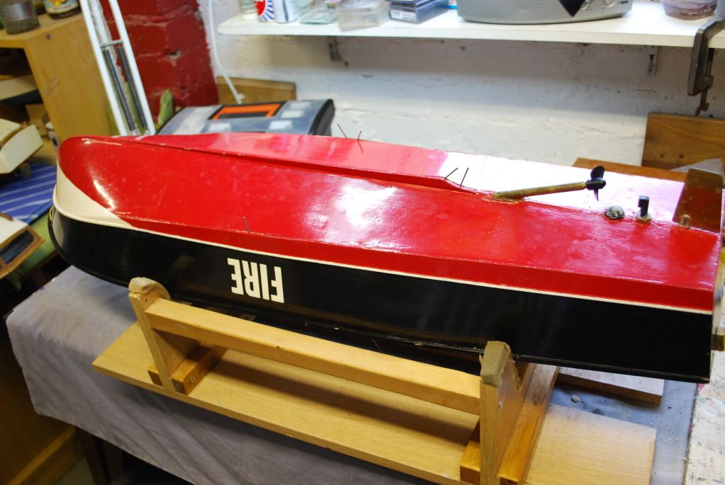

This is the boat in better times -not perfect, just better.!
I don't know what type of ply the boat was constructed from - I haven't owned it from day one
but it was my first dabble in to model boating.
I would like to have it available to run rather than just as a display model but you may be right to suggest
doing just that. I have noticed two or three of my boats with delaminating ply.
Some are easier to fix but this looks like i need to work on most if not all of the hull
to be sure to get her watertight again.
Yes, resin and thin glass paper looks a likely solution but I don't want to change the hull
profile to much.
Many thanks....

I think you need to find out why it is coming apart. Is water getting in due to impact damage? If so then cleaning out the crack, letting it dry out and then running in some thin epoxy or Super Phatic glue followed by some car body filler and then repainting will sort it out.
Have you let water lie in the hull after using the boat so that it has soaked in from the inside? Again, make sure it is fully dried out and then give it a coat of resin, plyester, epoxy or Ezecote all over the inside of the hull to waterproof it.
Hulls don't come apart for no reason. If you can work out why then you are half way towards a solution.

 Water is entering through the delaminations via the outside
 due to aged paintwork which has left parts of the hull exposed that I
hadn't noticed.
I've probably sailed the boat 3-4 times without noticing the underside paint wearing a bit thin.
There has been no impact - it is just a gradual deterioration of the outer paintwork. Plenty
of water taken on this last sailing (not a flood) drying out now while I enquire how to proceed.
Certainly no problem coating the inside of the hull - its the outside that I would like to apply
my best efforts.

One way to repair this fairly easily is to use a dremel with a roughing out bit or even a router bit in it,after you have done this fill it with 2 part epoxy personally I Zap epoxy please don't use araldite.Rub this down and use filler if necc to get the hull profile to the correct shape and simply repaint,I have had this on a couple of S/H wooden boats in the past and have used this method successfully.If you was to totally re tissue the hull it will become a major job.After you have repaired the hull I would personally strip all the electrics out of the hull and get some grp resin form halfords or similar mix the resin and simply pour into the hull obviously turning it so the resin can get everywhere to waterproof it completely.As others have allready stated make sure the hull has been fully dried out before attempting the repair

Hello Dave, Yes I will be leaving the hull to dry out thoroughly now then I think I'll
attempt  local repairs after removing some material (carefully) as you suggest rather
than treating the entire outer hull.
I need, of course, to stop the water getting in as a priority.
Was that 'Zap Epoxy' that you are using?
I have plenty of Halfords resin. (At the moment)!
Thanks...
Nordlys.

I've decided to lay a narrow length of fibreglass blanket down each side of the hull
where the ply join is separating and a length down the centre over the keel
and cover with resin.
This should prevent any chance of a leak through the joins at least.
I will cover any flaws and hollows with P38 - usually does the trick.
Drying out nicely now in the afternoon sun
I can post more photos as I go if anyone is interested -I'm grateful for all
the suggestions - so helpful to get a confirmation of an idea.
Nordlys.

Looking at the picture of you Hull, as you can see the original nails, would it not be better to strip all the paint away , sand , seal and then light glass cloth or such ? and then also run the resin inside the boat as well.
Nordlys
  • Posts: 868
  • Location: South East
Re: My first boat - splitting apart?
« Reply #13 on: August 31, 2012, 04:16:17 pm »
Yes, that is what I have in mind to do. I will strip away most of the paint in immediate areas
then continue with the process.
What kind of 'seal' would you use or have in mind?
The 'light glass cloth' I thought of using comes from Halfords - do you
know the type? Light enough?
And end up coating inside with a layer of resin.
