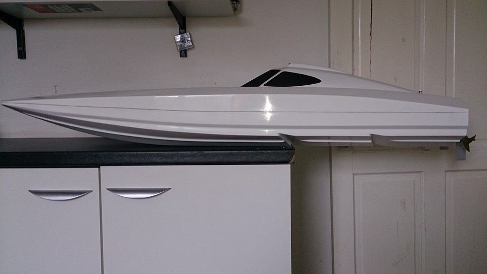

Made 1st hatch for this build,only thin layup to break in the mould but also 1st time test fit and check clearances round the engine ,fits nice and clearance is not an an issue so pretty happy ;)
Also now moulded the bottom of this build,fingers crossed releases ok in a week or so ,then wont be long before laying up and pulling the 1st hull ;)

Layed up 1st hull and joined just leave it few days now to cure,hopefully will release ok and ill start building it up ready for testing ;)

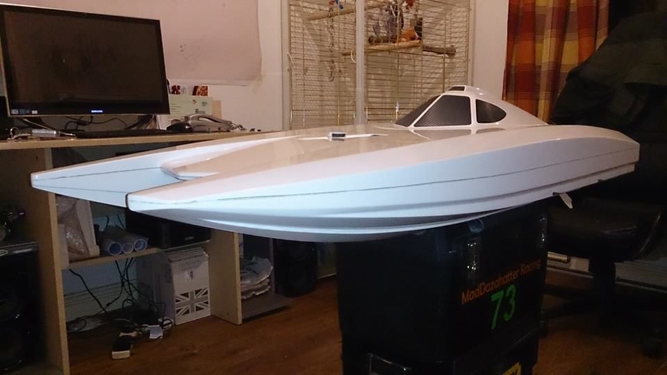

ALL DONE
Apart from vinyl and getting it on the water and setting it up shes ready to race  :-)) :}
