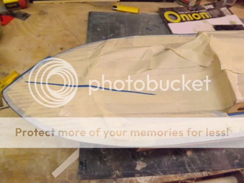

So it was now time to mask up ready to apply primer filler,the blue tape use is finne line tape made by 3m Tamyia do a similar tape,it is to prevent Paint bleed through.
Help was needed to get into tight corners so an old filler spreader was used
Primer being applied paint can in one hand Camera in another

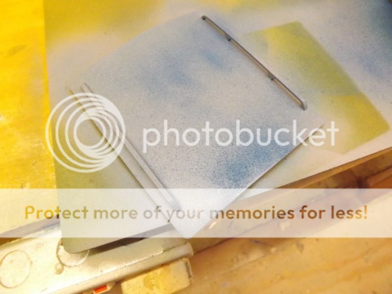

As the primer needs rubbing down a contrastring colour has to be applied as a guide coat,I usually advocate the use of black but as I dint have any blue was used,a thin coat is all that is needed
The Cabin roof had allreadsy had 2 coats of grey so all it needed was some more
This little lot were placed in front of the fire to harden whilst i had din dins
