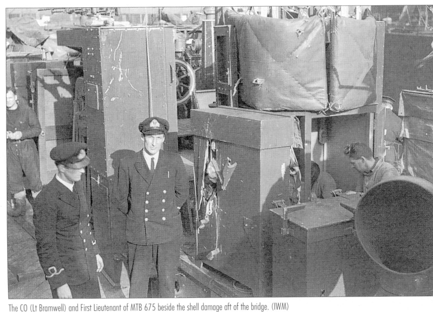

As far as I can see there is no door on the rear of the structure

looks perfect, this picture shows a little peep inside;

Looking at the image, there seems to be hinge detail near the top of the 'door frame' but no door unless it opens inwards? But then I do not see a handle either. Interesting. There is a bit of detail in the top right corner though.

I think there is a door, it's all the way inside and behind rhe seated operatur.

Christian, thanks for that buddy, lots of interesting detail visible in the area.
ballastanksian, think the detail top right is attached to frame on outside. The plans show a watertight hatch in the deck which I suspect the guy lower left is going down. Given the hatch I think it unlikely there would be a door.
Always handy to have a second interpretation of a pic,

For what it is worth seems to me the two guys "inside" are not going anywhere but are either repairing or gauging the extent of the battle damage on the inside. The photo is captioned "damage".
It is also possible that the "door" is gone, battle damage, as it looks like the remains of a door stile and hinge at the top, opening inwards but hey I am no sailor just looking at the pic.
Enlarging the photo may clarify more details.

Looking at the image, ther seems to be hinge detail near the top of the 'door frame' but no door unless it opens inwards? But then I do not see a handle either. Interesting. There is a bit of detail in the top right corner though.
I am glad the idea worked. I hate curving plastic so am always impressed when seeing other people's work that looks tidy.
At the risk of being contary the door is visible but not obvious.  It's almost edge on to the camera, swung past the wall line.  You can see the door knob just visible against the standing sailor in the background, just below his belt line.
Re: MGB658 Fairmile D @ 1/72
« Reply #62 on: January 16, 2015, 10:01:53 am »
That's exactly how it looks to me.

Here's a blow up.  The door is pretty clear now also visible inside the cabin is a brass Pyrene type fire extinguisher.

Nice one guys !
You've convinced me there is a door with the added bonus of identifying the fire extinguisher.
