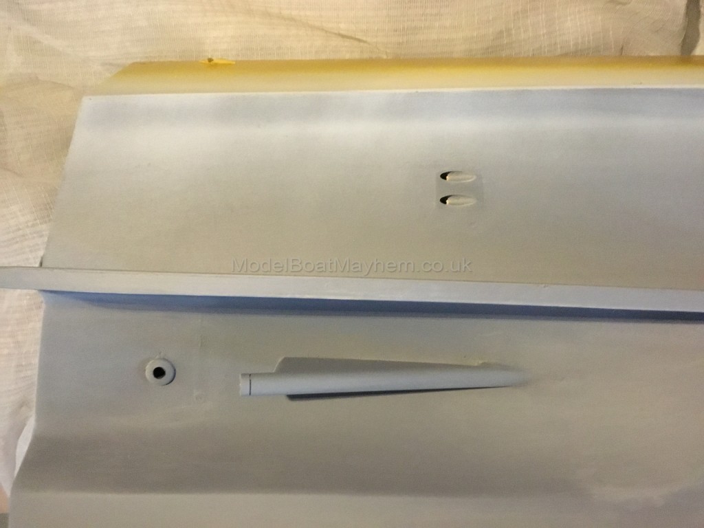

now it goes slowly forward .. first I would like to prepare the hull for painting and then drill everything .. grind .. this should also come to the two water inlets on the rear fuselage bottom .. but since they are not shown in the plans I need now necessarily the dimensions for the right position ..
It would be great if someone could help because they belong to the boat and 2. I would like to use them to cool the two controllers.

This is what I let into the hull, they’re commercial aluminium inlets.
The centre of the block is 145mm from the stern and 38mm from the chine. They’ll have the oval grills added when I’Ve made some.
Lance
