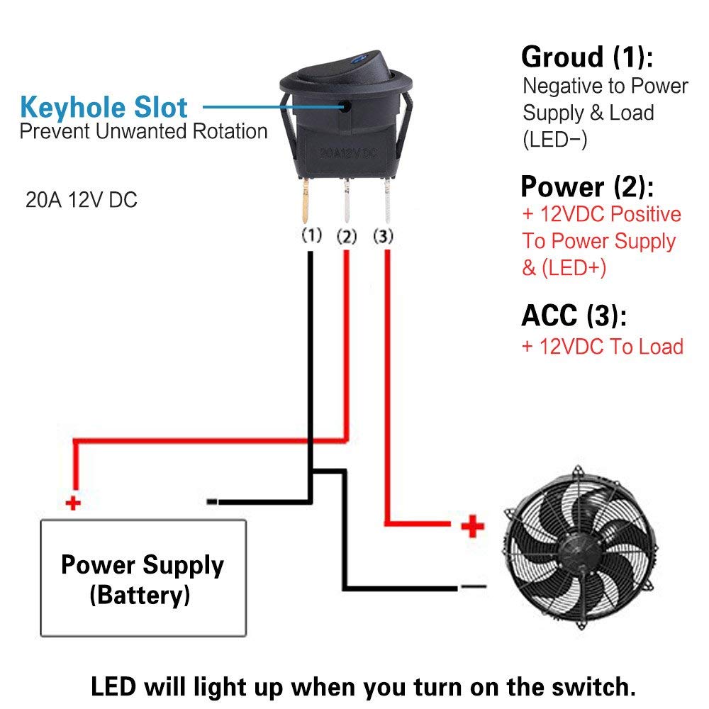

« Reply #37 on: August 03, 2020, 02:19:15 am »
Hi guys, a bit of a bump of my old post,
I just want to make sure i wire this up correct as i didnt get around to it the last time i made this post!
So here is the switch I have bought that i want to use (along with diagram it shows) :
Here is my current switch that i'm using at present that came supplied with my P103, as you can see it is connected via a futaba connector, so with the Black/Red & White wires, where would i connect them to my new switch that is shown above, i want the light to come on the switch when the power is on & then off when i switch the power off?:
Cheers!

Re: Illuminated power switch
« Reply #38 on: August 03, 2020, 09:28:58 am »
If the hope is to replace the change-ove slide switch with an on-off switch with an added indicator, it isn't going to work.
The slide switch is a low current device controlling the operation of the circuit that it connects to.  The illuminating switch connectos into, and directly controls, the power supply.  The illumination device gets its power from the main supply.  There probably wouldn't be enough current in the supply for the slide switch to work the tumbler switch, even if the on-off switch was going to provide the right functions to do the same job.

« Reply #39 on: August 03, 2020, 09:52:42 am »
Unless my knowledge of SPCO switches is sadly lacking, the set-up shown will cause a straight short between the two battery poles when contacts 1 and 2 are bridged. I'm also pretty sure that the P103 isn't supplied with a switch; it's a dual Schottky diode which prevents current from flowing between two parallel batteries. You're probably confusing it with either P107 or P112 - both of which already have power indicator LEDs fitted.
« Reply #40 on: August 03, 2020, 01:06:57 pm »
I don't think poles 1 and 2 get bridged.
Pole 1 (gold pin) is the negative supply to "in switch LED" and does not form any part of the switching circuit which is only between poles 2 & 3
Or at least that's how I read it - odd that it may be!
C-3PO
« Reply #41 on: August 03, 2020, 01:22:04 pm »
C-3PO
That would make sense, and I've no problems with being wrong! I would question the need for an LED indictator as part of the switch, though, especially if there's another one just down the line.
« Reply #42 on: August 03, 2020, 01:25:03 pm »
Looks like when the switch is off the voltage does not connect between contacts 2, 3 and 1, with only the load connected via the -ve, when the switch is connected, the voltage connects from 2 to 3 and then through to the load and back to -ve, then there is a resistor and led where the power travels through 3 to 1 for it to illuminate - correct?
« Reply #43 on: August 03, 2020, 02:57:57 pm »
Very much so, which is probably nothing like what happens with the slide switch which just connects the center pin to either the left or right pin.
« Reply #44 on: November 18, 2021, 09:44:48 am »
it worked, i just connected it up with the black/red wires for the Pos & Neg on illuminated switch & then i connected the white lead to the other connector, no issues & works as should :)
« Reply #45 on: November 18, 2021, 09:48:29 am »
DaveM
your correct, it was the 107 i have which has a switch! & as you pointed out, LED indicators, but the power switch will be mounted above deck under a hatch for easy access to switch on/off so the LED's on the P107 wont be visible, hence why i wanted to fit this illuminated switch, but all sorted now & works good :)
