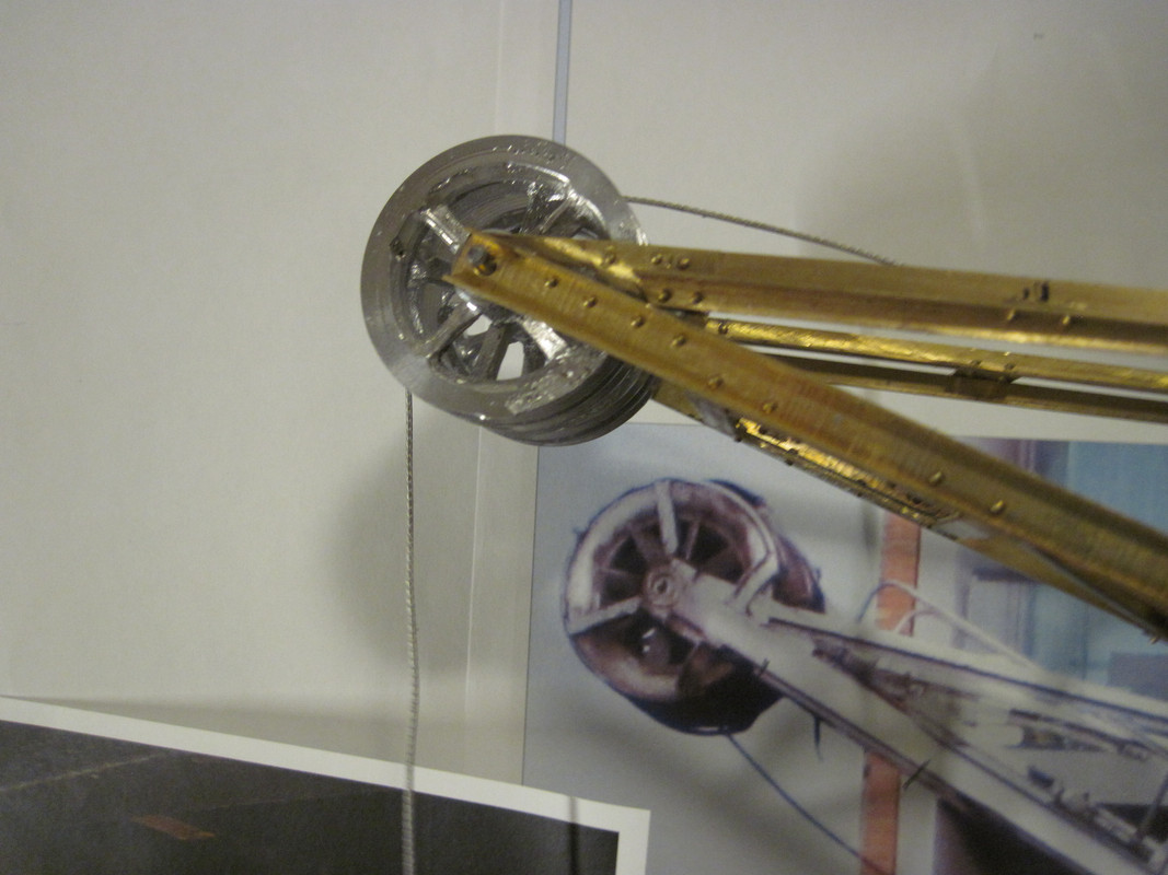

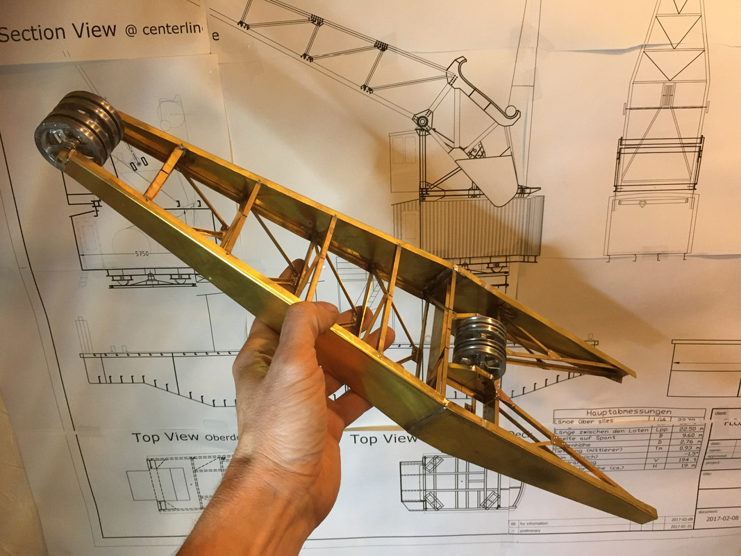

oh the time is running  %)  but itīs done. I finished the boom.
The counterweights are made of thins 0,5mm brass. from photos.
the weights are empty I filled later.
Ralph

Excellent, Ralph. A masterclass in brasswork.

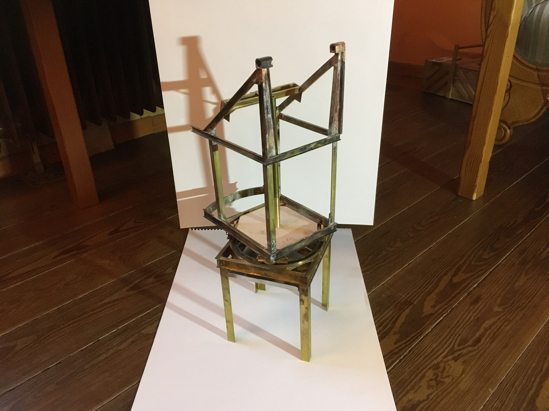

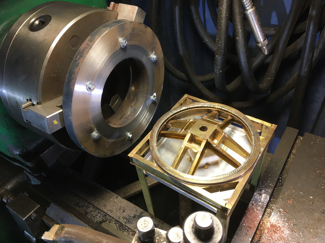

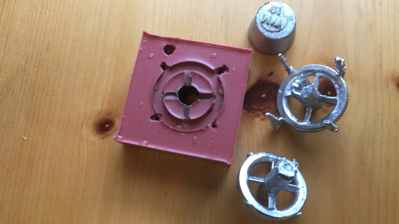

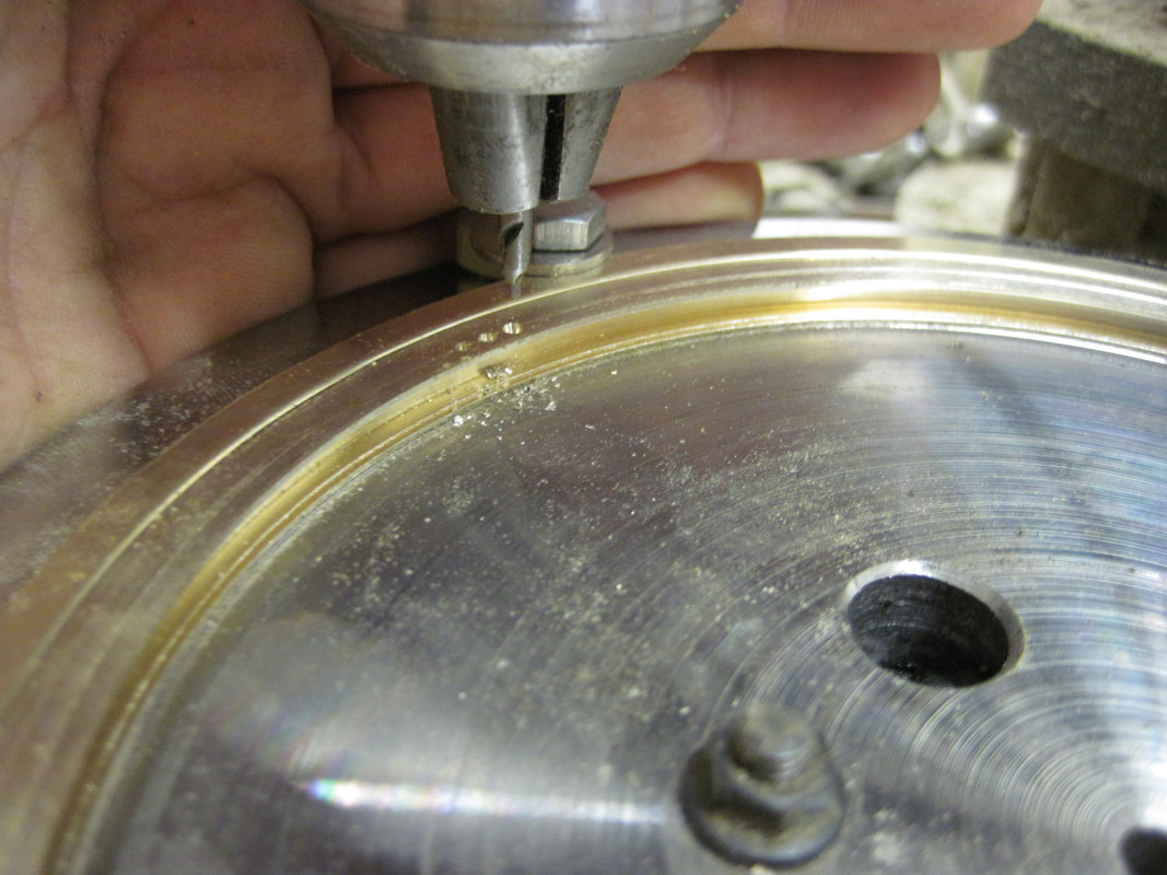

One year break is over
[/size]rope disc cast and machined
[/size]
[/size]
[/size]The slewing ring was not easy
[/size]
[/size]
[/size]
[/size]The structure is standing

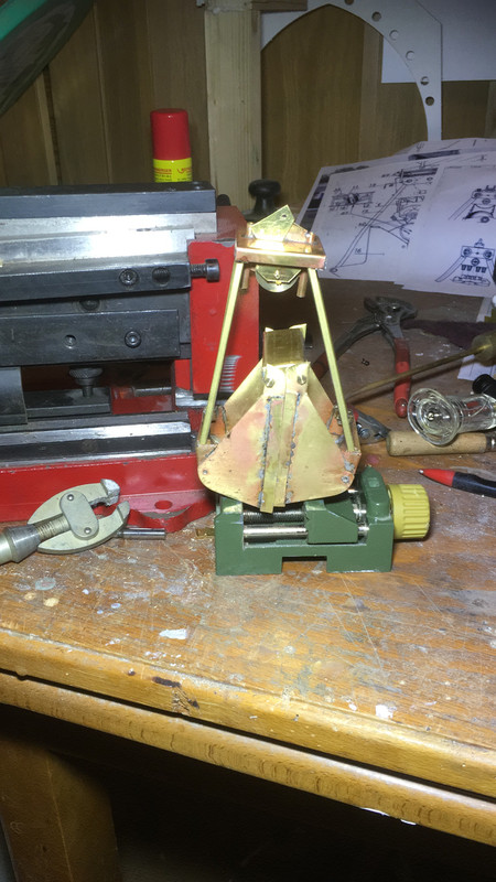

The Kran has function, has a Bucket and is going to floating. It's not the original hull, test only
All so I had buildhave 1m ladder
At last the video
https://youtu.be/opkSTv49BlA
Ralph

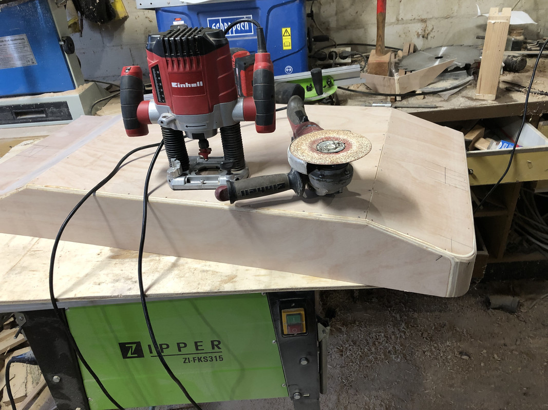

A little carpentry and I have a hull
Ralph

Ralph......
Many of these 2 jaw Clamshell crane buckets have a secondary trip wire to open the jaws
Details in the following link may assist
https://www.rctruckandconstruction.com/showthread.php?t=13646
taucher
  • Posts: 76
  • Location: germany
Re: floating crane "Greif"
« Reply #48 on: January 21, 2024, 07:12:41 pm »
These too. Not shown in the film because the winch is still being worked on.
https://youtu.be/YDcBxJMJwF4
Ralph
  • Posts: 9,576
« Reply #49 on: January 21, 2024, 08:15:38 pm »
Super mechanism Ralph & working well  :-))  even in real life, the tripping mechanism is a delicate design function  :o
