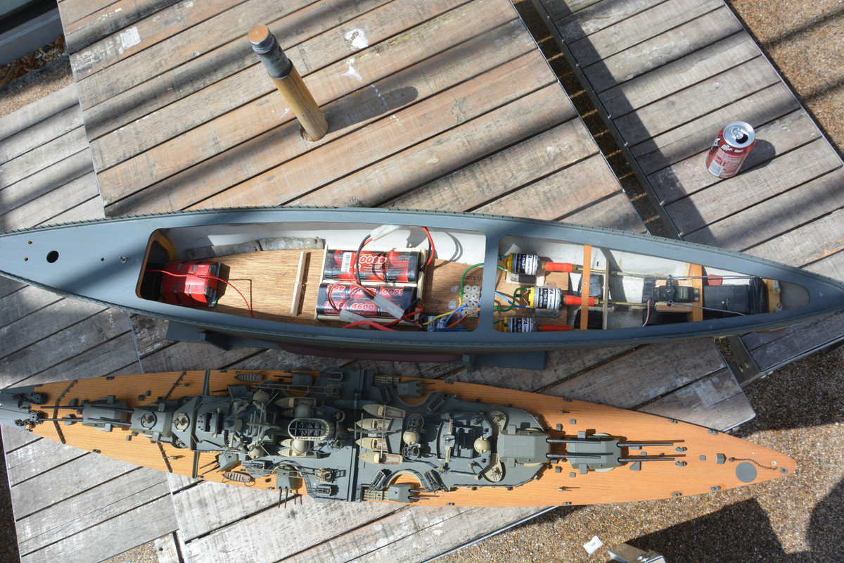

Re: Bismark drive system
« Reply #14 on: June 20, 2021, 03:01:26 pm »
My internals.
7.2 volts about right speed, 8.4 volts a speedboat!
