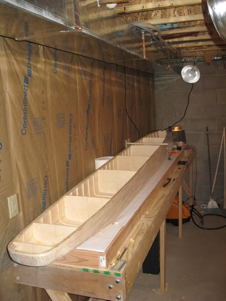

Hull progress good, all but the very tip of the bow is done:
http://i262.photobucket.com/albums/ii92/capricornzzz/thIMG_0599.jpg
Plenty of room (I think), and should have 70 to 100 lbs payload (minus hull), but some of that may need to be bottom ballast.
