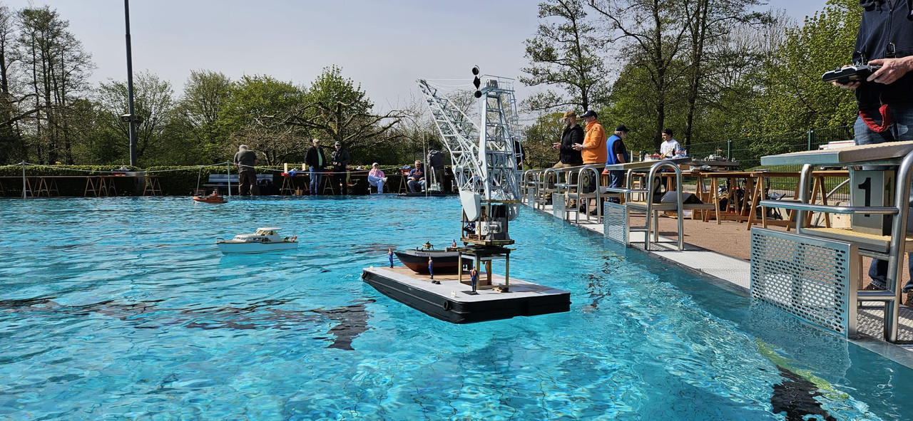

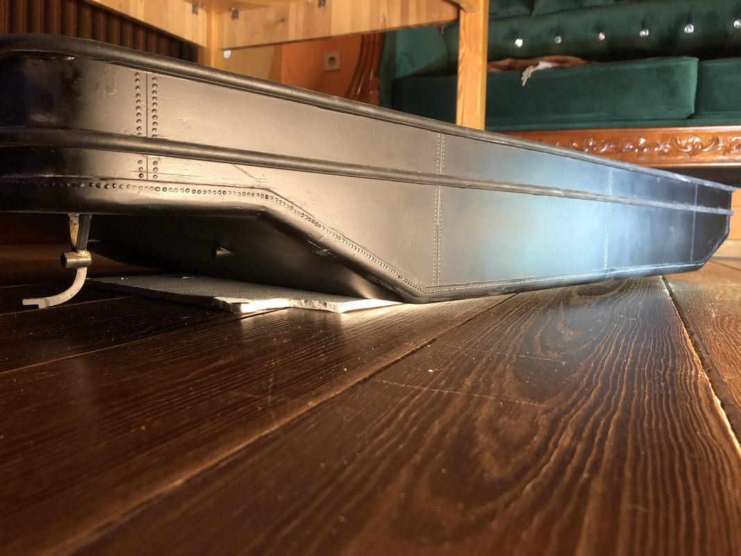

« Reply #51 on: May 01, 2024, 05:34:59 pm »
The hull is buoyant. It is a box made of 4mm plywood but decorated with rivets. And for the first time in his element.
https://youtu.be/lmtS83Gmb6k

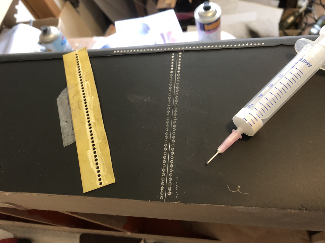

« Reply #53 on: May 02, 2024, 07:40:15 am »
Hi Ralph - your rivets look amazing !  wondering how they are produced please?
Guessing blobs of PVA? dropped into what looks like a scratched/scribed? circular outline to constrain the glue??
if I'm correct what gadget creates the circles?
Looks a great solution to a tedious problem - I have an ongoing project requiring metres of the little blighters !!

« Reply #55 on: May 02, 2024, 11:34:27 am »
It was a impressive sight to se it sail past us  at Roland's Oase, we were 10 Danes that went there this year.
A lot of very impressive models this year, and Subwaterfilm's were there as usually  :-))
Only downside were that the main pool were out of action as the groundwater had pushed up the bottom of it.

« Reply #57 on: May 02, 2024, 06:43:51 pm »
Hi Paul
is a template made of brass sheet, I used a milling bench for it. Rendered in pencil. The plate joint is scratched with a needle. And then drip on simple wood glue.
