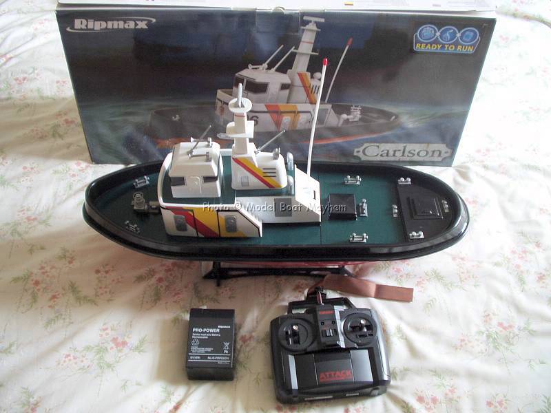

Well Santa decided that I needed to get to the pond prior to completion of my current build projects and gave me a RTR Tugboat, the Carlson by Ripmax. A very nice tug which passed the tub trials. She comes with decals and fittings for the detail, however I intend to make a few aesthetic changes and rename her in honour of my recently deceased mother-in-law and call her My Irish Lil.
When I was going through the manual, I noticed that 'all the grease has been removed to fall within EU regulations and to please use vaseline to lubricate the parts required'.
So, any of you dealers or professionals who may have seen this RTR tug, am I to take the pre-installed prop shaft out to lubricate? and the rudder as well?
still high and dry at my bench.  ???
