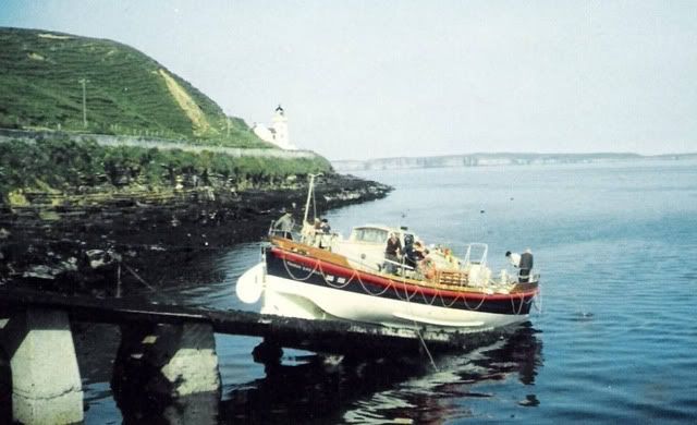

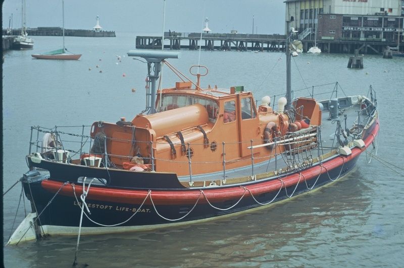

A 47 can be built at one of three periods per boat. The first, exemplified by this photo of Helen Wycherly, is as built. The first half of the class had Kent Clear windscreens as standard, the second had normal wipers. All had folding windows.

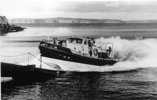

The second period is around 1970 when the lifeboat fleet began to be modernised. Patches of the superstructure went orange, and radar was fitted. This is Solomon Browne.

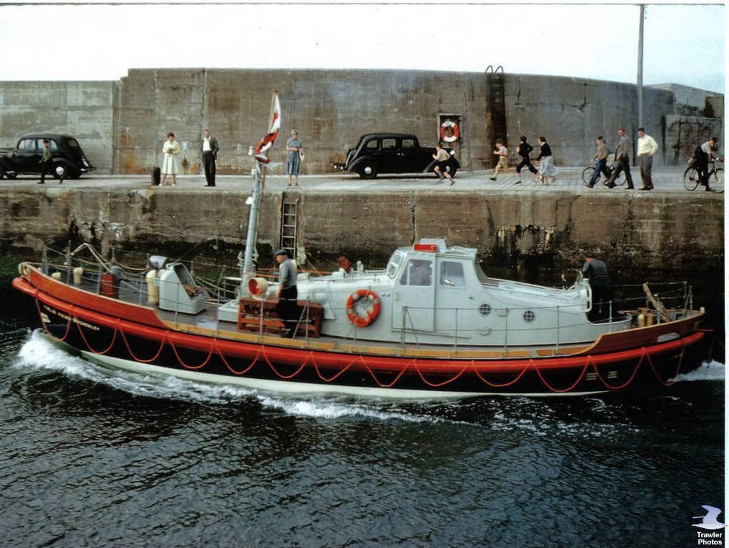

In the late 70s the R.N.L.I. converted all their boats to self-righting. in the case of the 47 most of the boats were fitted with an airbag on the rear cabin deigned to inflate if the boat heeled over beyond 100 or so degrees, while 6 boats were highly modified with what's been called the 'Solent Conversion' which meant fitting a larger superstructure to make the boats inherently self righting. While the airbag-fitted boats all look fairly similar, the Solent conversions were different on every boat. (I have photos of 3 or technically 4 of these conversions)
Frederick Edward Crick, of Lowestoft
Joseph Soar of St. Davids

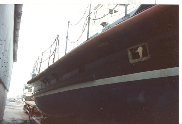

Now back to the boats, and focussing on scuppers. There are varying types in the lifeboat fleet, from the single-flaps of the shallow water boats like Liverpools and self-righters to the two- and three-flap scuppers of the deep water boats. I believe that the 47s had three-flap scuppers, and this is what I've put on. The moulding must be given credit for the recesses into the rubbing strake where the scuppers go, that get shallower as you go aft.
How the flaps were finished will vary from boat to boat, but at least on Solomon Browne, Pentland and Helen Wycherly all but the 4 scuppers furthest aft are painted blue, while on those left the flaps are left as bare bronze. I don't know about the others.
Pentland
