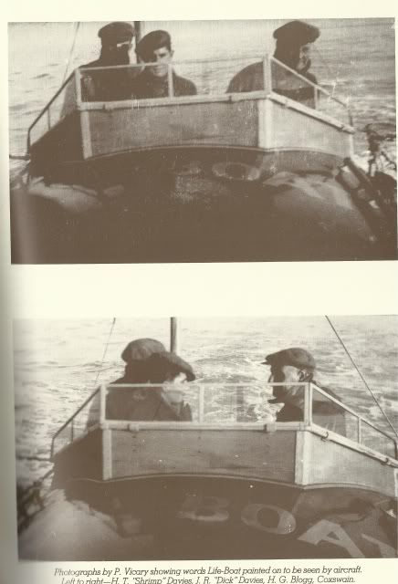

I hate to point it out at such a late stage, but I think the windscreen frame on the H. F. Bailey is wrong. The photographs I have show it in two stages:
When she went into reserve, part of the rear canopy was filled in and she was given a single piece windscreen, which she still has today (the outline of the original cut-out in the canopy is still visible)
But when she was built she had a three piece screen, but the frame for this I think was flush to the edge of the canopy and covered the complete rear edge.
I'll try posting up a couple of photos when I get the chance tomorrow to show you what I mean.

Hi Andrew, Now according to the plans, and a little tell tale strip of timber on the aft cockpit top to verify the early position, the shape was as I have done it.........however, it did have two different heights to it, and the height I should have done it too, for war time guise is about twice as high as I have actually done......which I'll rectify by adding a section later....see the photo of the cabin strip.
cheers for the input though.

heritorasphodel
  • Inactive
  • Posts: 282
  • Location: Near Canterbury
Re: 3 Lifeboat builds, What goes into a model kit.
« Reply #417 on: March 28, 2012, 07:43:05 pm »
This was the photo I was talking about
Cheers,
Andrew
  • Posts: 1,953
« Reply #418 on: March 28, 2012, 08:57:30 pm »
That's the one Andrew, but the frame comes well forward to the lines of that little piece of strip timber that shows on the H F Bailey as it is today at cromer......it's level with the aft stanchion of the hand rail at it's foremost point, as it shows on the plans.

Having read what you mean again, I now understand what you are getting at....in that the canopy top in fact took the line of the wind sheild.............not according to the plans or the cross sections that I have.......the canopy followed the line that I built it to, andrew.
