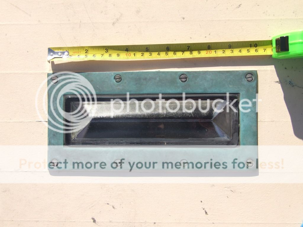

Re: 3 Lifeboat builds, What goes into a model kit.
« Reply #685 on: May 25, 2012, 08:31:00 am »
Neil,
I've sailed on boats with this sort of deck light, although not a lifeboat. They are usually made from a block of glass, which looks green in reflected light. Bottle green - as in glass bottles. When looked through from below, they are transparent. When looked at on deck, they select the surrounding light, but generally look black with the shape of the prism showing.
Hope this helps.
Chris
  • Posts: 1,946
« Reply #686 on: May 25, 2012, 11:01:06 am »
cheers Chris.......will look for some green plasic.

rmaddock
  • Posts: 2,051
« Reply #687 on: May 25, 2012, 11:04:07 am »
If what Chris has shown you is the right thing, then here's a picture of one of those fitted to Hearts of Oak (c.1912).

  • Posts: 1,946
« Reply #689 on: May 25, 2012, 12:23:05 pm »
Cheers Rob.....they were all basically standard fittings so those'll be the ones. cheers.
