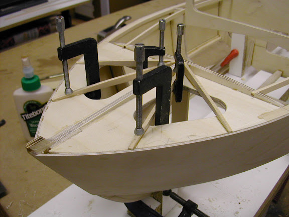

As you can see there has been a bit more progress. I’m quite surprised at this myself but then it is all the ‘big bits’ getting stuck on at the moment. Things will slow down once the ‘fiddly bits’ begin.
This shows fitting a couple of supports for the deck at the bows. Incidentally does anyone know of a source of these small clamps? they came three in a pack for a pound and I'd dearly love to get some more.

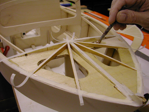

Water proofing the bows and underneath the deck using two pack Tufcote fuel proofer. The benefit of using this as opposed to other resins is that it dries very quickly on the workpiece but remains very fluid in the mixing cup for several hours.
